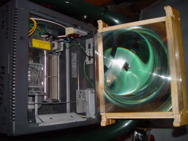

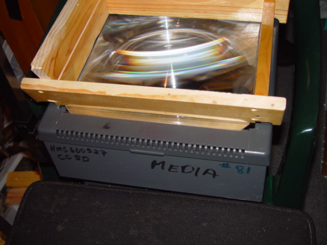

i posted a pic below to show where the bottom fresnel was placed
gui_999 said:
Omg I think I've understand. The wood frame replace the top of the OHP. By that I mean that you remove the top plastic part that have the fresnel and glass stage.
So you can take appart the fresnel and place it in your wood frame, with the lcd, fans on the sides. And you place this frame on the ohp, where the plastic part was. So to resume, you "rebuild" the top plastic frame, with a homemade wood frame.
you dont remove the top of the ohp you just modify it by that i mean cut it enough to allow the light to hit the whole lcd
the wooden frame suports the 2 fresnels and the lcd ontop of the ohp top plastic frame as you can see in the pic above

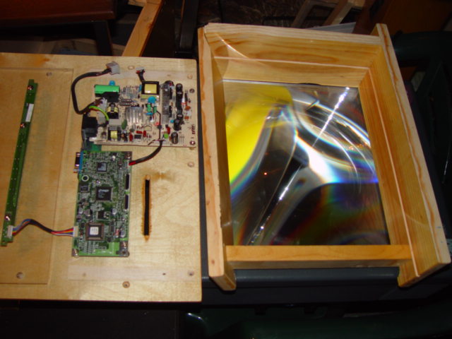

now here are some more pic's of the setup
you can see i cut a 3/16wide and 1/8 deep groove 2" from the bottom of the fresnel that is where the lcd inserts to suport it on 2 sides
the vertical side with the small pcb rests on a 2" piece of wood the horizontal side with the large pcb is suported by a piece cut at a 22.5 degree angle
