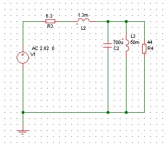

Could you guys please explain to me how to create a spice model for a speaker driver?
R3 is the measured DC impedance of the coil. L2 is the measured coil inductance. C2, L3 and R4 is the problem.
...or am I missing it more than I think?
Please help.😕
Funny you should ask, because I was going to post the exact same question before I saw yours.
What I've found in my researches:
http://www.silcom.com/~aludwig/Sysdes/Thiel_small_analysis.htm
Lces = (Bl^2) * Cms
Res = (Bl^2) / Rms
Cms = Mms / (Bl^2)
Now, what I don't know is how to compute Cms, Rms and Mms from Qms, Qes, Sd, Vas and Fs. For now I'm using BassBox to compute them for me (it has that "Compute All" button), but some formulas would be nice. I wasn't able to find something usable on the web.
