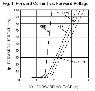

I've seen a tendency to use the Red LEDs. The graphic below is from a Fairchild LED datasheet. From it, one can see that the red LED has a steeper If v Vf curve. This is desirable because the voltage drop is less susceptible to changes in current. (In the case below, forward current is rather high: >10mA, but I think this phenomena holds true for the lower current varieties as well.)
FWIW: I've read (but not seen data) that LEDs are quieter than zener diodes. I would like to find actual noise data for LEDs.
JF
John,
please forgive the ignorance of a non-native speaker, but
what colour is "HER"??? 😕
My measurements are similar.
I once measured the red, green and yellow ones I had.
Biased them from 1.0mA to 2.0mA, with steps of 0.1mA and put the voltages accross them in a spreadsheet.
Red was best, then green and yellow had a considerably less steep curve.
Note, this is with my LEDs, YMMV of course.
Out of curiosity I checked the datasheets of some LEDs from
Everlight, which is what the local supplier here sells. I basically
just checked a couple of 3mm LEDs all having their typical
values rated at 20mA. Their mileage does seem to vary indeed.
All diodes in the range from yellow to yellow green had an
almost linear characteristic, while the red ones had a more
normal exponential type curve and the blue ones were rather
inverse exponential. I checked the voltage variation
between 10mA and 30mA for these and there were no big
differences, but yellow, sunset orange and yellow green seemed
the to have the smallest voltage variation, ie. the steepest
curves in this range.
