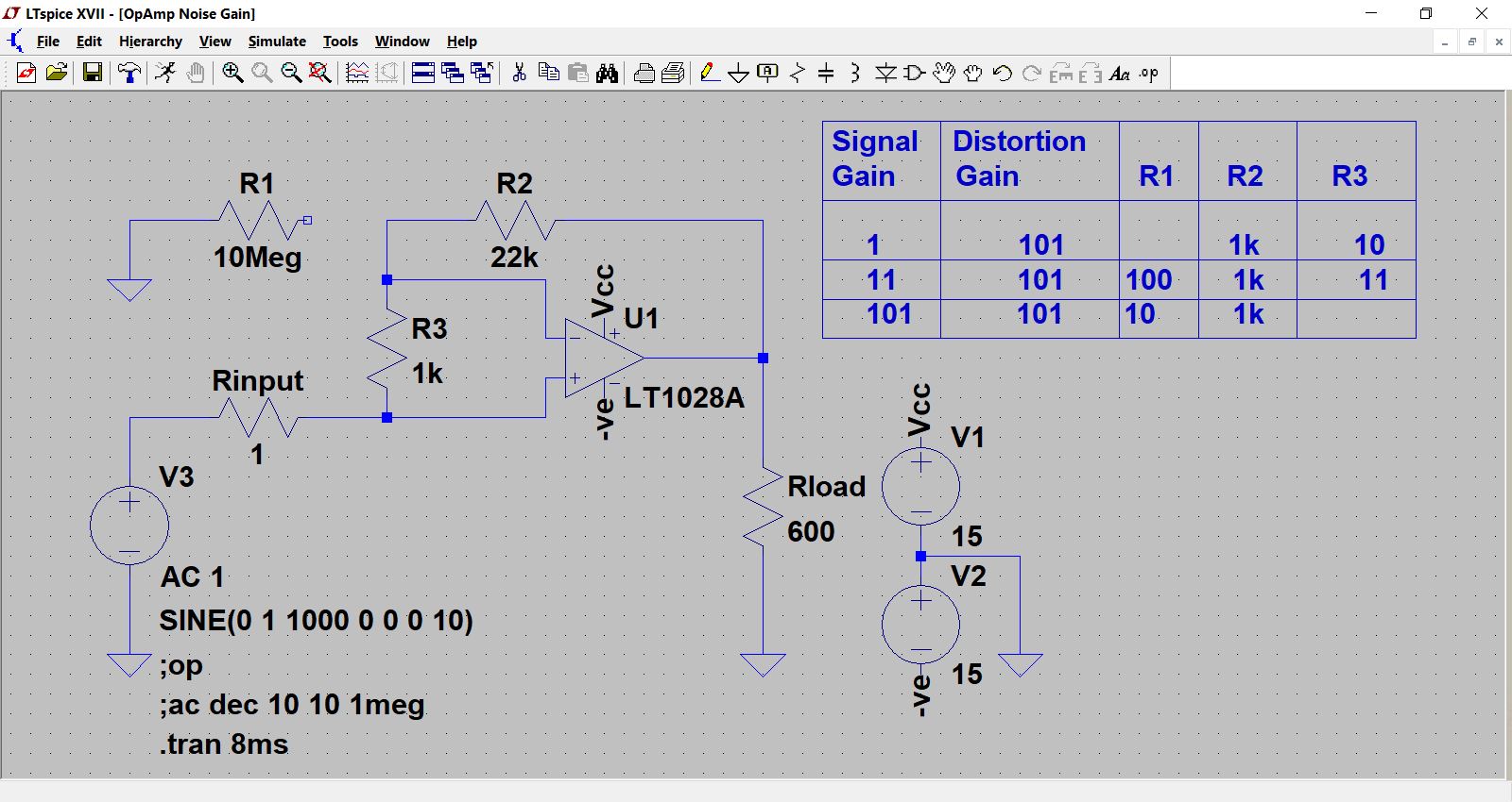

I am about to build some test equipment and was considering using a TDA2040 in the output. My concern was the stability at unity gain. Has anybody a spice model for a TDA2040 or TDA2030? Has anyone tried running these at unity gain?
The idea is to generate a spit supply from a 24 volt plug pack (wall wart to some) so the supply will be +/- 12 volts.
The 12 bit DAC output from a Xmega micro will supply the signal. DC to audio frequencies only. Voltage out +/- 8 maximum. Good output control at mV required so I may have digital gain control (relay Hi Lo).

You could try running the chip with an increased 'noise gain'.
R2 and R3 as shown here give a signal gain of 1 (unity gain) while the chip is happy as it sees a standard feedback network arrangement. There are many variations, this is just the basic outline.
