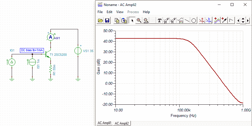

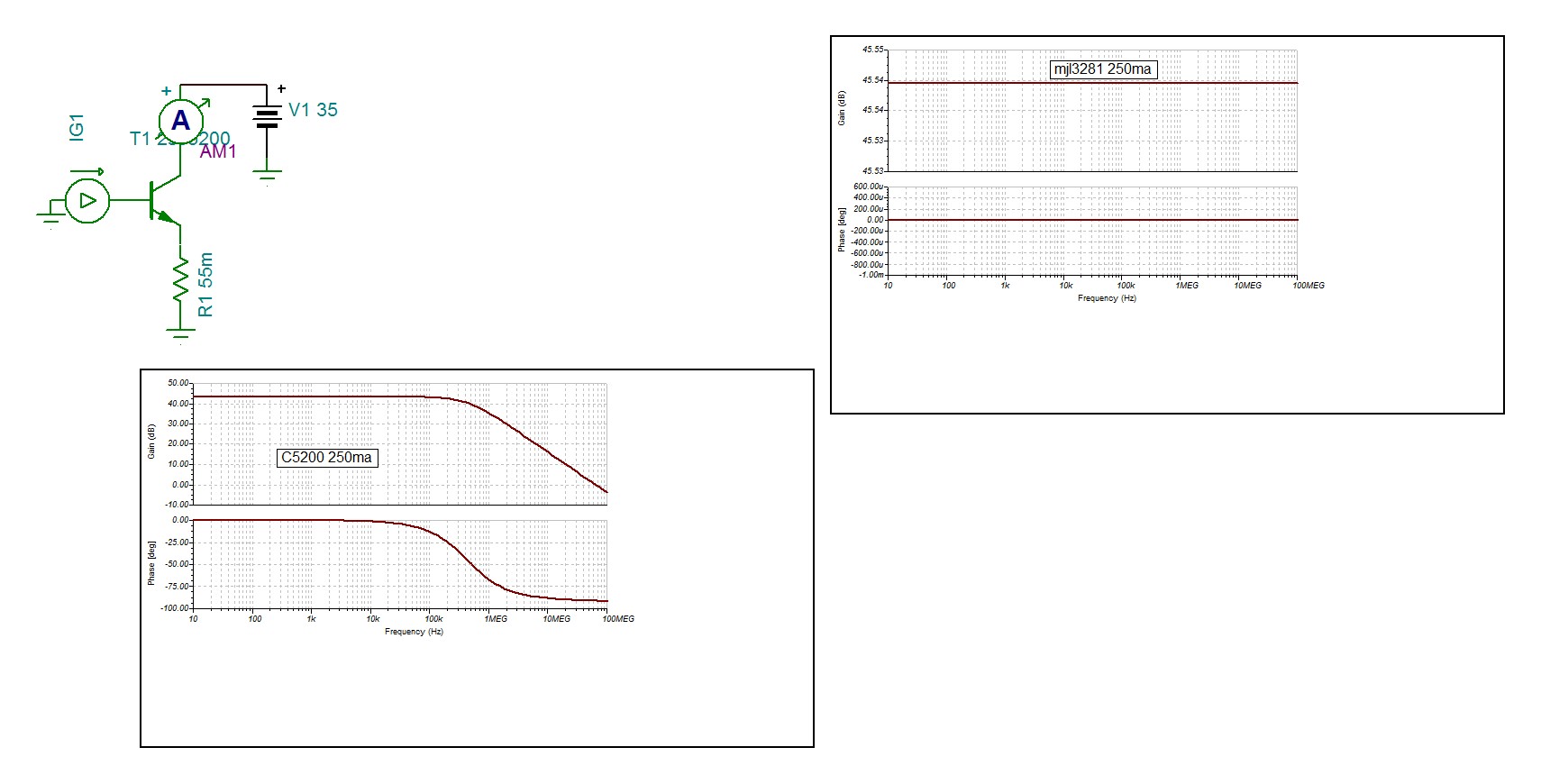

The spice models provided by Onsemi , cordell , Improved SPICE Models for MJL3281A and MJL1302A - Section 1 , do not work in time domain. The internal emitter resistors about 0.04 ohms , can see on datasheet Ic/Vbe function is also forgotten . Can someone help these transistors models work?
It works on LT but not on Tina. Any suggestions?
