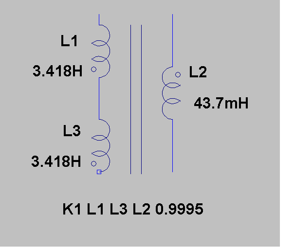

Simplest example, ie SE, single output.
.SUBCKT 5KSE P1 P2 Sp1 Sp2
* Single ended audio transformer
* 5k to 8 ohm, 10 to 40KHz
LP1 1 P2 40.26021568H ; PRIMARY
LSA 2 Sp2 0.064416345H ; SPEAKER SECONDARY
KALL LP1 LSA 0.999499875 ;
RP1 P1 1 56
RS Sp1 2 .1
.ENDS
P1 and P2 are the primary ie plate connections, and Sp1 and Sp2 the secondary ie speaker connections.

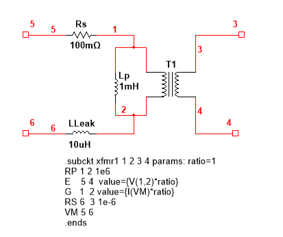

Going to repeat here what I posted on the vacuum tube spice page. This is cobbled from Christophe Basso's book on switch mode power supplies. Add the parasitic elements to your heart's content. Multiple sections can be added in series and parallel to derive a UL transformer of your choosing by changing the parameter "ratio" in the spice model:

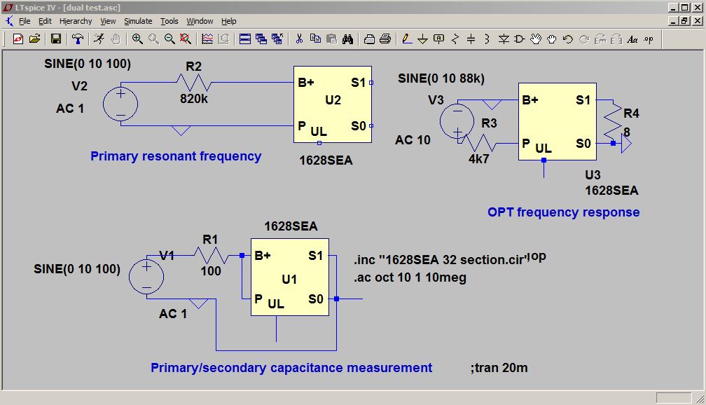

32 section Hammond 1628SEA's UL model
I have attached my implementation of a 32 section distributed lumped element LTSpice model of the Hammond 1628SEA OPT.
This post is not meant to be complete or scientific, but please let me know if I am on the right or wrong track.
I was interested in attempting to model the primary-secondary capacitance and in particular the amplitude and phase relationship between the plate and UL taps of the primary at higher frequencies.
I had bench built a simple SE 6CA7 UL stage using the Hammond but had seen oscillations when connected in UL mode, but not in triode or pentode mode. Testing the OPT showed that around 88kHz there was a 180 deg phase shift between UL and plate connections, with V(UL) becoming larger than V(plate) (and leading to positive feedback to g2 I guess) so I wanted to see if this could be modelled in Spice.
The model is simple in that the primary and secondary are split into 32 mutually coupled inductors with the primary-secondary capacitance distributed as 33 discrete capacitors between the respective primary and secondary inductor nodes. In addition I have included dc resistance, primary winding capacitance, leakage reactance (manifesting as the coupling coefficient) and a series cap-resistor to attempt to model HF hysteresis losses….. (not very scientific I know…)
I found that the 32 section was an improvement on a 16 and 8 section model because the model performance in simulation was less sensitive to the input capacitance values, otherwise you end up with oscillations in the simulated circuit that are not there in real life.
To get the parameters not listed by the manufacturer I had only a LRC meter, oscilloscope and signal gen at hand, so used 3 small test circuits to measure parameters, then simulate the test circuit and compare results.
Extract of the sub circuit model:

.SUBCKT 1628SEA 1 2 3 4 5; P B+ S0 S1 UL;
X1 1 2 3 4 5 OPT LP=45 RP=5000 RS = 8 RSP = 178 RSS = 0.5 LPL = 25.8m CPS = 3.5n CP=0.5p CPP=1n RHL= 1000 k = 0.4 RPP=546k
.ends

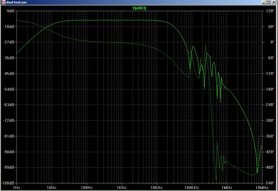

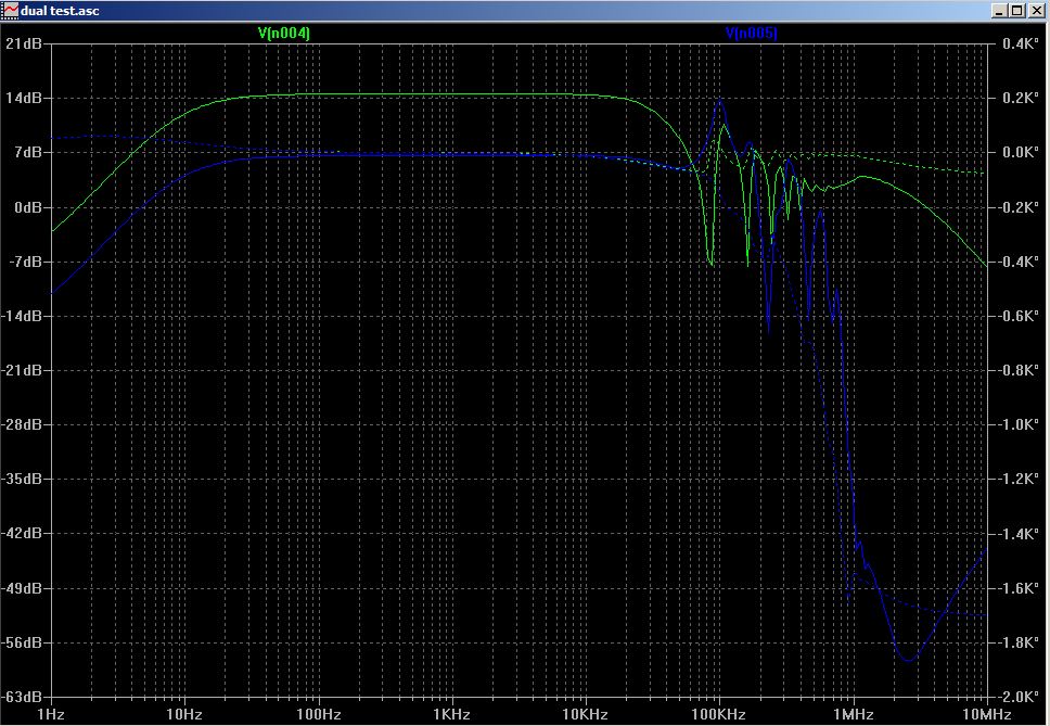

This model does simulate the OPT performance reasonably well and shows the UL plate relative amplitude and phase change in a satisfactory way, although the frequencies at which this resonance occurs differs slightly in real life. Installing the model as a subcircuit in Spice correctly predicts the oscillation I observed at the bench, and allowed me to eliminate this with a 470pF capacitor between g2 and plate.
I have attached the simulated transformer frequency response for the plate connection (green) and the UL connection (blue) which shows the amplitude and phase change, very similar to what I measured.

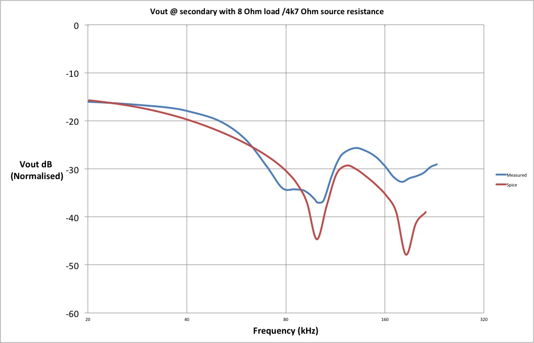

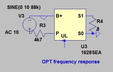

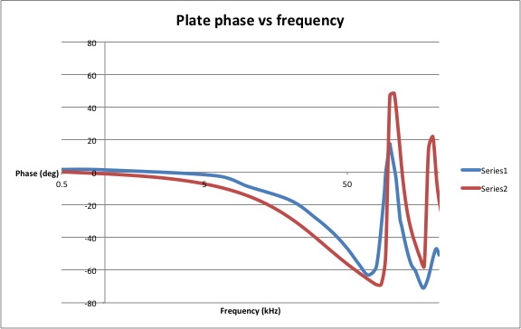

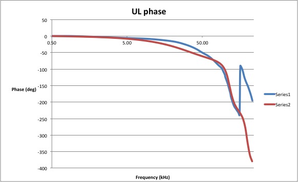

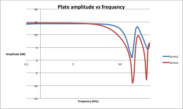

Yes I did measure... I have attached a few results with the Spice comparison

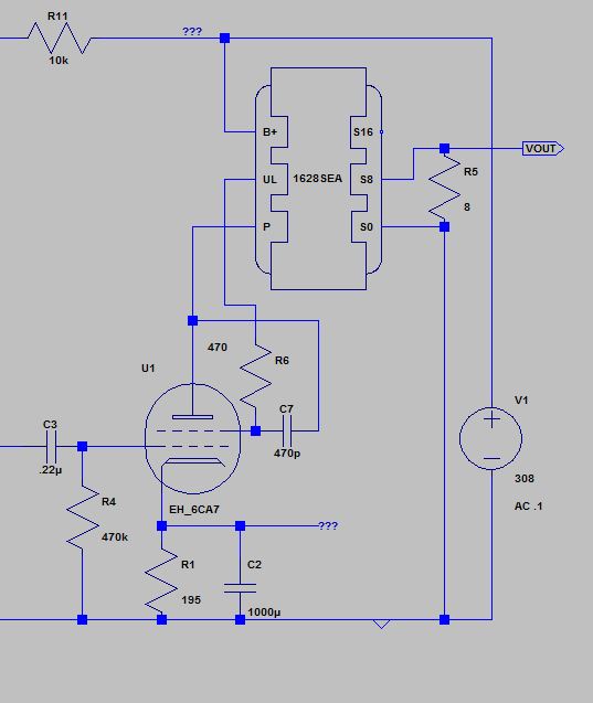

I agree it is a bit like taking a sledgehammer to a crack a nut and does slow down the simulation somewhat. It is not clever but simply an interpretation of the physical that lets Spice do the maths for you. For a small SE type circuit the wait is not too long, but long transient analysis will take time.
It has been a useful educational exercise for me and it did correctly predict the oscillation with UL connection,and confirmed the corrective measure would work without having to stick my hands into HV!
If you know the physical winding arrangement you can construct any model that represents the OPT. I have now added the (not connected) 16 Ohm tap and it is interesting how that changes the resonant frequencies.
All good fun. Time to now build the real thing.
