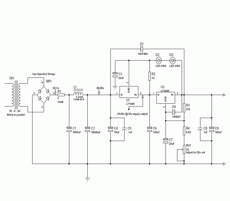

Hello all. I just downloaded a circuit simulator from here:
http://www.newburytech.co.uk/Pages/download.html
I would like to simulate the PSU below but I noticed that there is no spice model for an LED. Does anyone know where I could find one? Yes I have searched using google and have had no luck. I've never used a simulator before. Any advice is appreciated.
