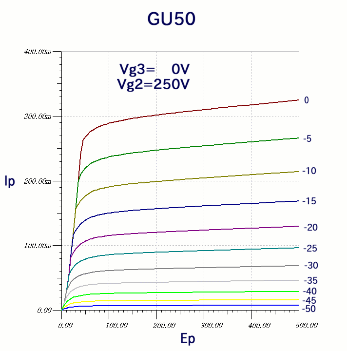

I can say that Ayumi`s pentode models faultlessly good and precise.
I have made a GU50 Pentode model by Ayumi's method with the
following conditions.
*Measured Ep-Ip data from the experimental data of (GU50.xls)
which is located in Next-Tube. Experimental data of vacuum tubes.
*Ayumi's method can handle Vg3=0V only.
The model obtained is as follows:

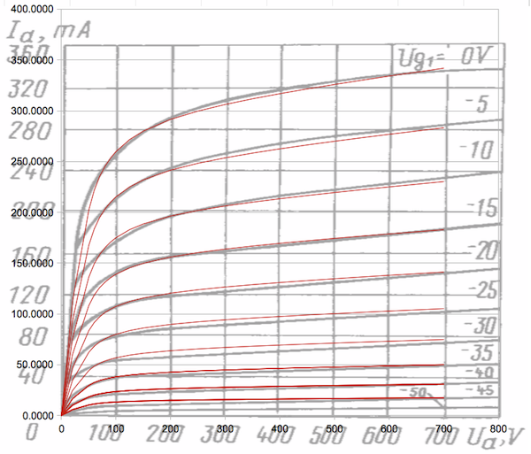

GU50 Pentode Model vs Datasheet, Round 2
Using smoking-amp's triode-strapped curves with some minor adjustments, here is the result of the pentode model made with Ayumi's method vs. the datasheet. So the tubes probably came from that factory.
ja2dhc, I thought we are not suppose to post copyrighted material here... Perhaps, you can check with Nakabayashi-son to see if it is ok for us to do so, since I was told once on this very forum that it was not allowed (unless with permission from the copyright holder).
And sorry, I accidentally deleted the Koren spice model vs. the datasheet I posted earlier...
I have been allowed to post the models derived from Ayumi's methodja2dhc, I thought we are not suppose to post copyrighted material here... Perhaps, you can check with Nakabayashi-son to see if it is ok for us to do so,

Thanks, that's good to know. I hope the moderators and the others will make a note of this because there are far too few Ayumi models in circulation. My goal is to persuade people to stop using the Koren and Munro pentode models, since they are typically poorly made and far from accurate.

Your model looks A+G2+G3 are connected.
Yes, it's the so-called "right-hand" mode, nice curves though.🙂

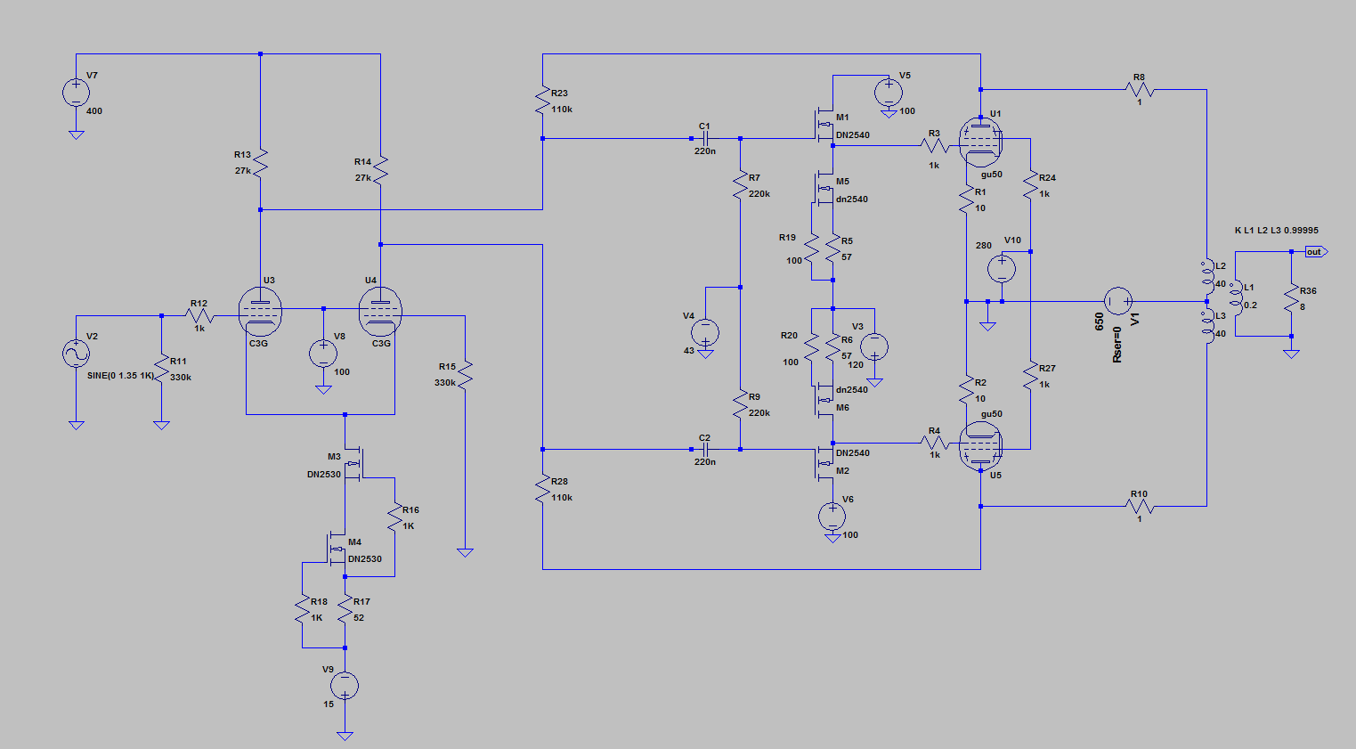

My differential amp using C3g is shown in the below URL.
http://ja1cty.servehttp.com/6080/6080pp-web.gif
Both G2 's of C3g are connected and pulled up by 147Kohm from +350V
instead of fixed voltage. This connection affects to differential
operation as well as common cathode.
