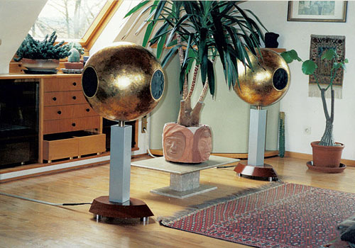

Made out of bowls from Target eh. I thought about using some bowls from under our sink today as making them with plaster would take too long (because of waiting for the plaster to be delivered). And cost much more than I really want to spend. I'm sure someone would have been angry if I did.lol
Thanks - I enjoy them every day and at times I push them (and neighbours) quite hard and they are up to it (the spheres that is!). I feed them 500w/ch from B&O Icepower.
Sorry, no building instruction but most of it is in the thread really. If you have questionss I'd be happy to answer them.

edit: smallangryboy, congrats to extreamly nice execution of both speakers and stands !!!
