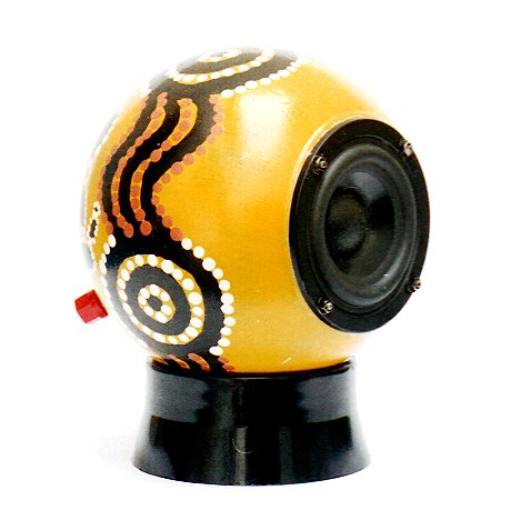

Ferguson Hill also do a sphere. THe Orbs sort of look
very Gallo'ish. The custom paint work is great fun!
Luxman also do some spheres in Aluminium.
They had 5 with tweeters going for AUD$199 in West OZ

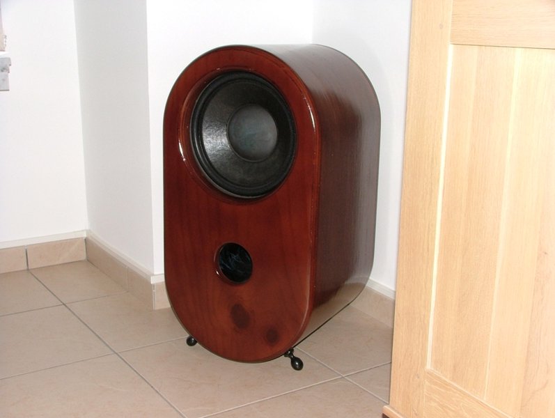

not really a sphere...but cool none the less
12 sides...10 of them have drivers....

Wow, those sure are perdy speakers pneuma! I'm sure they cost a pretty penny too being carved out of marble and all
Alas, they are not mine. I found those by googling for spherical enclosures.
As pointed out, they aren't actually subs, but they are a killer concept nonetheless.
