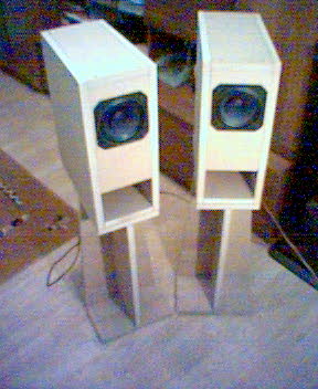

I have built a TQWT with this speaker. Plans were discussed in this recent thread:
http://www.diyaudio.com/forums/showthread.php?threadid=24176
I´m quite impressed with the bass performance, although the speaker must be toed in to the listening position because the highs are really beamy.

Hi everybody
six month ago I`ve build ct193 ("Klang und Ton" magazine 1/2002) with sph-60x, I`m very impresed with the sound from 13cm drivers. Great sound for about 100 euro !

I've built ML TQWT with SPH-60x.It used to bit a monopole,then I turned it to a bipole.Without BSC it can sound harsh and dull.If BSC added it sounds way better.I cannot say that I found optimum BSC with this rear driver,but it is way better than monopole.I don't think it is specially good FR driver.It is just average IMHO.I'm no specialsit for FR drivers,since I haven't tried many,but I found many 13 cm mid bass drivers from Monacor which sound way better than this one and they are not much expensive.If you add them a tweeter you'll have much better sound than with a single driver sph-60 x version.
If you want to make a bipole,it isn't worth of it ,cause for little more than that you can buy a 2 waycombination and put it in TQWT.Bipole DOES sound better,but it is worth of making if you have a good driver,which in my opinion SPH-60x isn't.
