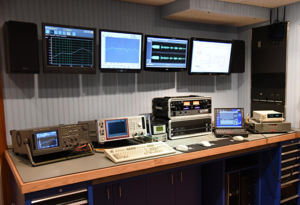

For self contained instruments, I like the Tektronix AM700 because it's easy to use. I also have the R&S UPL. Better specs & more features - keep the manual handy.
For a two piece system, an Audio Precision System One or Two, a USB interface, and a laptop or PC running APWIN software. Really stay close to the manual with these.
Here you can see the AM700 and the UPL on my audio bench:

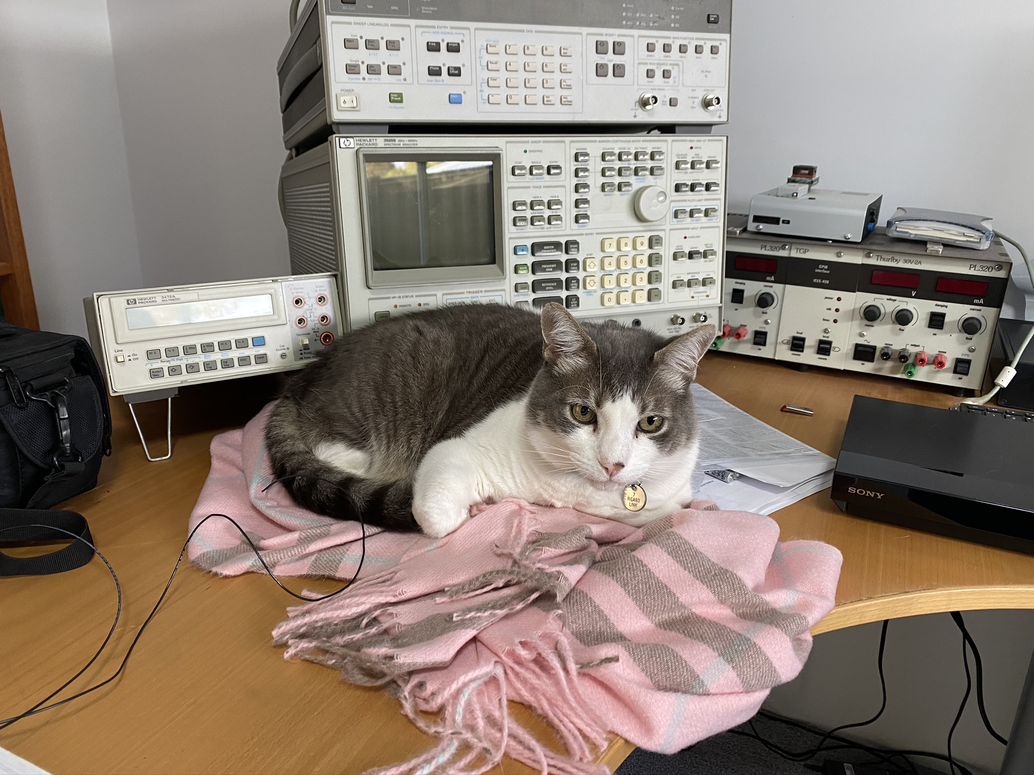

HP3585B.
Bit weighty, but it does DC-40MHz, with close to 100dB dynamic range, nice quiet front end with 50Ω, 75Ω, and 1MΩ inputs and good up to 7V. Res bandwidth down to 3Hz. Also calculates noise in 1Hz bandwidth at marker.

Art asked: Just curious what do you do on this work bench, there is no room!
Do you work on cell phones?

I called this a 'flex' bench with the idea that it has the flexibility to be set up to conduct whatever test or experiment I don't have room for elsewhere. It is three and a half feet deep and nine feet wide
I have other benches for diagnostics, soldering, rework, & RF.
I don't work on cellphones.
