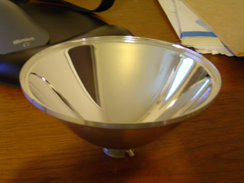

I'm starting this thread to document my progress on building my latest projector. I will be updating with new info about once a week. everyone feel free to respond to any theories or ideas I post because constructive criticizm is always welcome. My equipment is as follows:
150w mh philips master color, ordering # CDM/150/T6/942
aluminum parabolic reflector from 2 million candlepower portable spotlight
lilliput 7" 800*480 lcd
precision cut fresnel for lcd from ace3000_1
7" by 5.5" hot mirror from rosco industries/ you will see why in the design.

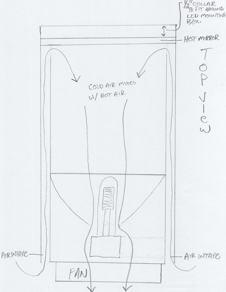

I am going to use sheet aluminum to assemble my light engine, and it will mate to the fresnel/lcd housing which will be made of wood. I am attaching a rough draft of the design below, the final specs will be posted as soon as I get it finshed. Any comments or warnings are welcome. will post again soon.

About your draw I have to say that the air will not go out from de ligh engine because the reflector ocupy all the place. Unless your box is wider than the reflector there is no place to the air to pass trough.

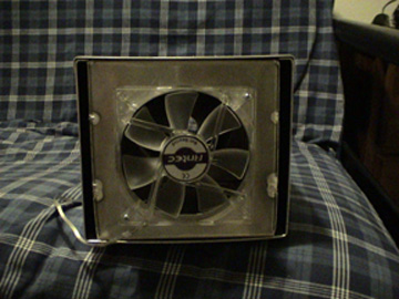

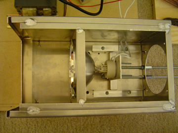

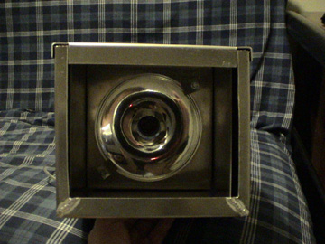

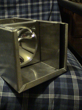

The following photos are of the final assembled light engine. If anyone has any questions about how it works refer to the drawing in my above posts. I performed tests using a 300w halogen bulb and the resulsts were great. The airflow ducts worked perfectly, and the light box itself became very warm but not to hot to leave your hand on it for a long period of time. with the hot mirror in place and using the cooler metal halide 150w cdm heat should not be an issue. The reflector created a very even light at fresnel focal length of 210mm. Looks good so far!
this is the front view looking directly into the reflector. If you look closely you can see the middle part of the fan through the hole in the reflector. when I get the hot mirror, it will be placed at the very front of the engine between the relector and fresnel. the fresnel and lcd will be mounted in a different box that will be attached to the light engine.
In this pic you can see the open area between the outer case and the inner case that forms the air intake. This is the front side where the hot mirror will be placed, so the air pulled in from the rear intake will cool the mirror and mix with hot air in the main light box and then pass between the gap of the bulb/ reflector and out the fan exhaust.
Here is the pic of the light engine in its last configuration. the only thing missing is my hot mirror which has yet to arrive and my fan. The long threaded poles allow for precise bulb focusing, and the rails inside maintain proper azmuth alignment. I plan to cut the excess when i get everything assembled and working. So for everything works as advertised. If anyone has any suggestions please let me know.
