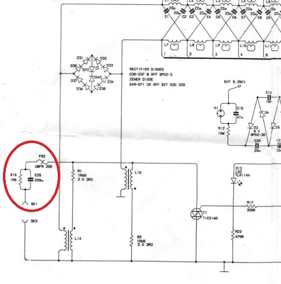

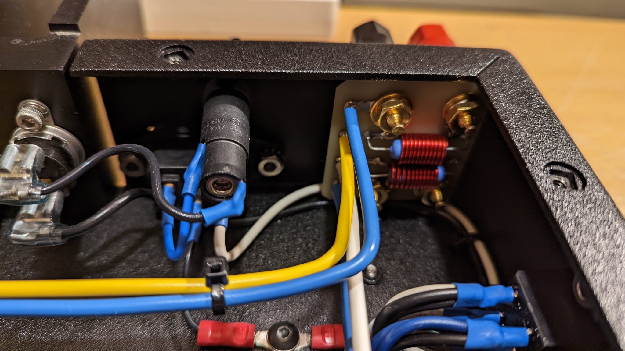

My Quad ESL-2805 appears to have a Zobel already...
EDIT - whoops, thats not a Zobel...in parallel, and not across the outputs
EDIT EDIT - a pic of outputs with coil / resistor across output...doesn't this serve same purpose as Zobel, preventing reflected HF back to amp?
