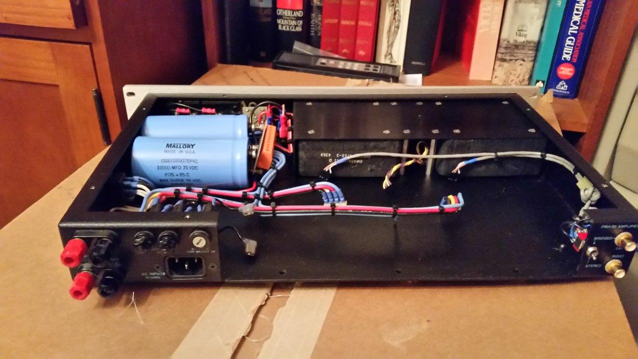

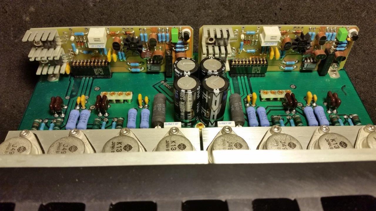

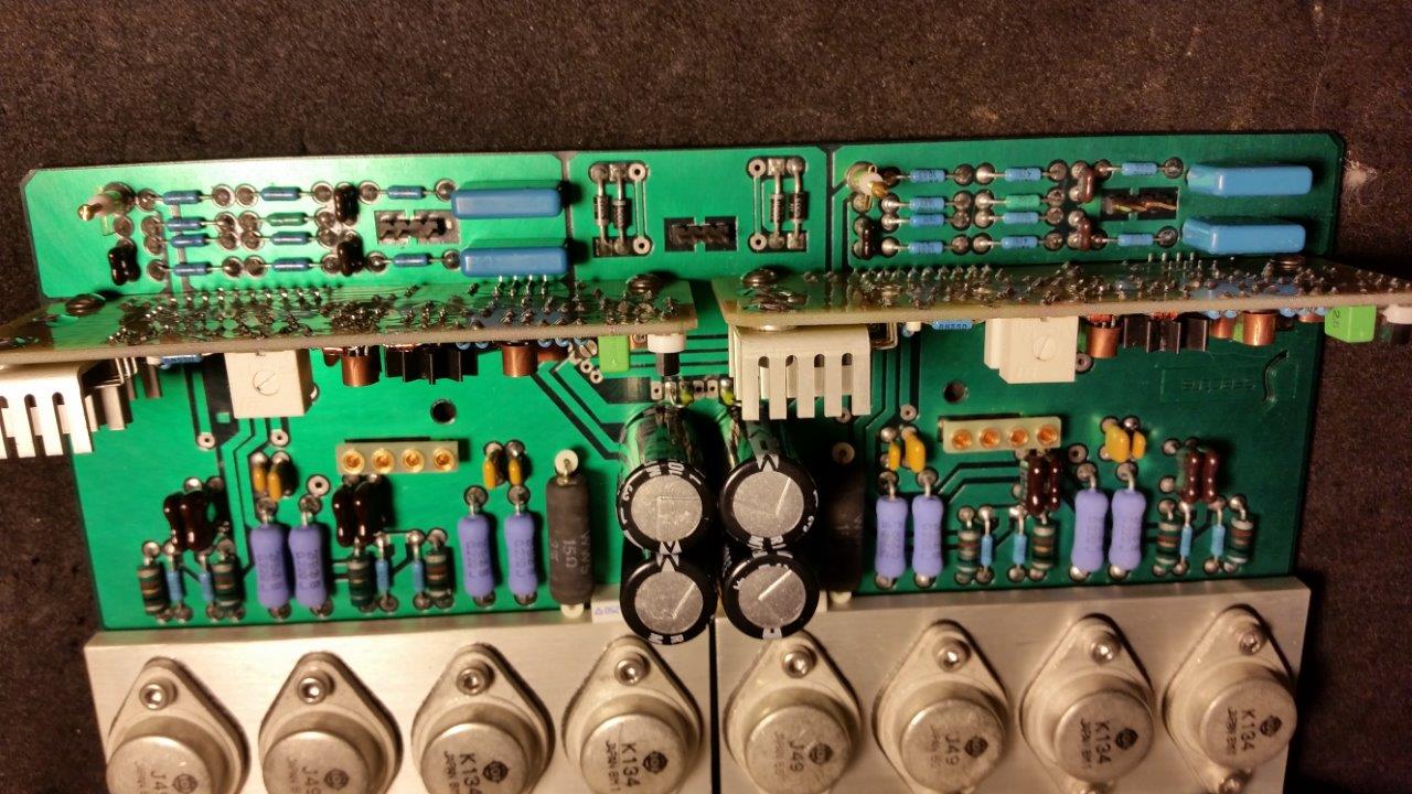

Here are some photos.
I had removed the board to look for burn spots and look at the solder joints and everything looked ok. I will go back and check a little more closely.
I do not believe the unit was ever opened prior to me so everything (including the pots) are undisturbed.
I don't have a scope so I can't look at waveforms (don't know if I would know what I'm looking at either...)
