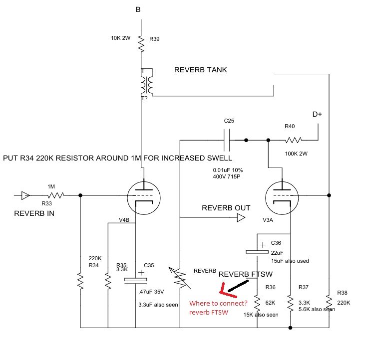

Specification Mesa Boogie output transformer mark II simulclass
This schematic is it correct?
