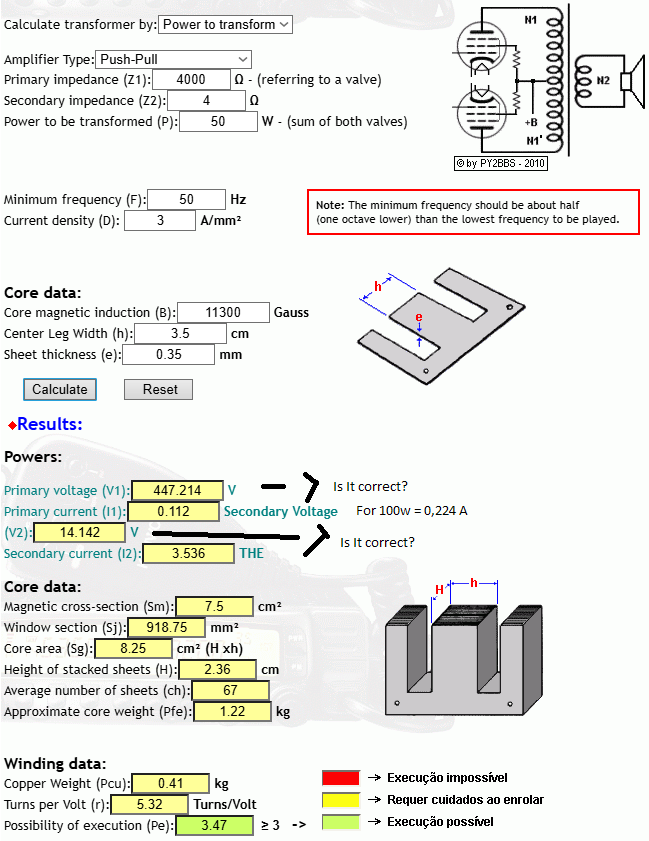

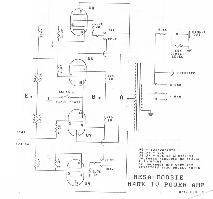

Hi! I am making a mesa boggie mark II diy. I made almost parts and I already test of the pré amplifier. I made transformer of power.
So, I still missing the output transformer and inductors of EQ.

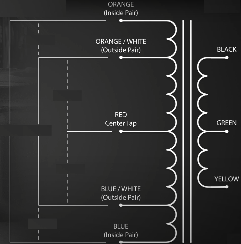

Does anyone have the specification of output transformer? I'll wind the transformer myself.
something like that? What would the resistance look like?
