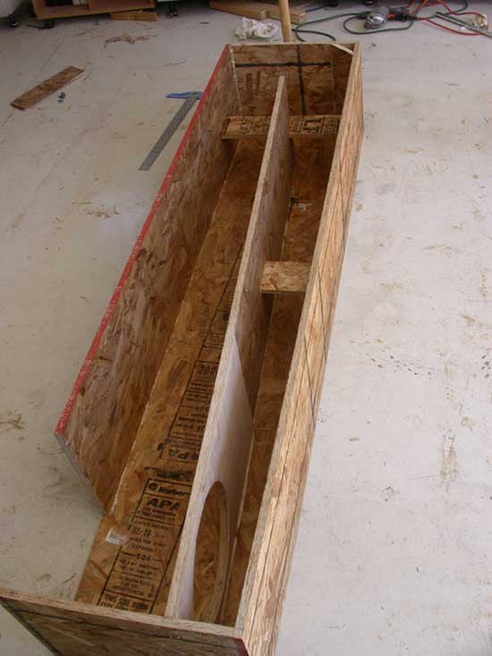

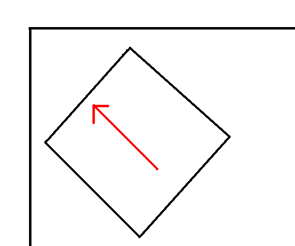

Update about TAPPED HORN !
I build tapped horn with four EOSONE 12 inch.
the bass is very loud but not at the good place in room.
the problem is I can't move the box because I build this subwoofer outside the room and only the mouth is in the room. (in front corner)
anybody have TIPS to change "the BASS sweet spot" without move subwoofer ?
because for the moment all the bass is in the back corner of my room.
Room size = 22W x 14L x 8H
thanks in advance 😉 !
nicK

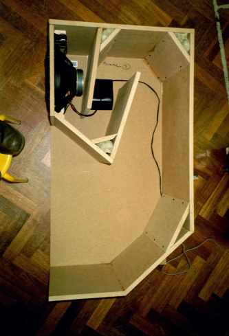

2) Some damping of the walls at the closed end is desirable, same as a TL. See 'geitmans' work: http://s670.photobucket.com/albums/vv68/geitmans/spud/

You will need to add a fairly serious diffusor system to deflect/smooth it out.
GM
