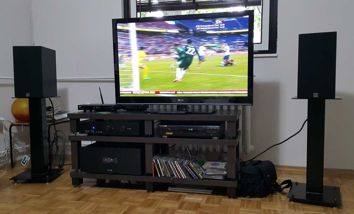

in fact , almost any decent spk will work with Papamps ;
My speakers aren't particularly sensitive (~89dB, 6 ohms) but in fairly small room, even the
original Zen or mini-A worked remarkably well.
me likee , how they look

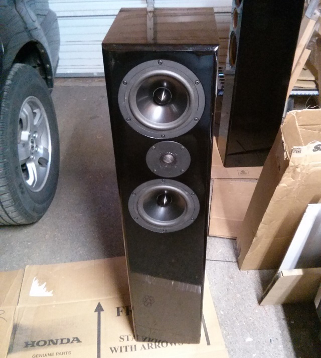

Lots of efficient speakers you guys have...
I run KEF r700 (89db, 3.2 ohm min) with a dual pair mosfet f5 (24v rails) and it's fine up to sane volume levels (90db at listening seat). If you listen at 85 db (probably average for most people) it's only putting out 4 watts.
So, for those of us who listen at sane levels you don't have to have efficient speakers.
I've listened to the same amp with a more efficient single driver speaker as well. It was more efficient but it didn't like to go loud so it was kind of counterproductive.
My point is don't limit yourself to really efficient speakers with these amps. If you have the current, wattage is not the main problem.
