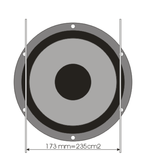

In regard to Dynaudio Volvo item, you could advertise it as 9.4" unit because its Sd=235cm2, regardless of the smaller diameter frame it has. TS parameters are relatively close to Dynaudio MW182 except it has Re=3.0 and higher Fs.
Dynaudio used a different standard of evaluating Sd back in the old days when specs were written for 24W, so it is said to be 220cm2, and by todays rules the effective piston area measures from center to center of the half roll surround.

The Dynaudio - Volvo woofer I have for sale has 3" voice coil dia. It is same/similar to the MW170 model (older model). It is not similar to the newer MW172.
Theile-Small parameters for this Dynaudio unit are likely different than the 24W75 unit.

No, the woofer you are selling, the one that went on ebay for years and was always described as being 8" class unit, is effectively of the same cone as a 24W. Measure the effective piston area diameter and you should be able to read 173mm. Actual TSP are irrelevant.
I know that because I have bought also a pair of 8" Volvo drivers and they are what I am telling you. I also own 24W75's.
