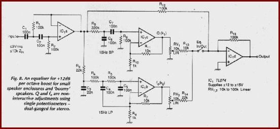

planet10 said:
Is that similar to or the same as a Linkwitz transform (which i forgot to mention in my earlier post)
dave
Hi Dave,
Yes but more simple and adjustable. Here is the schematics of an enhanced version from Hegglun. For me it worked impressively with a B&O Beovox S45 (8' bass Peerless) driver in a little room.
