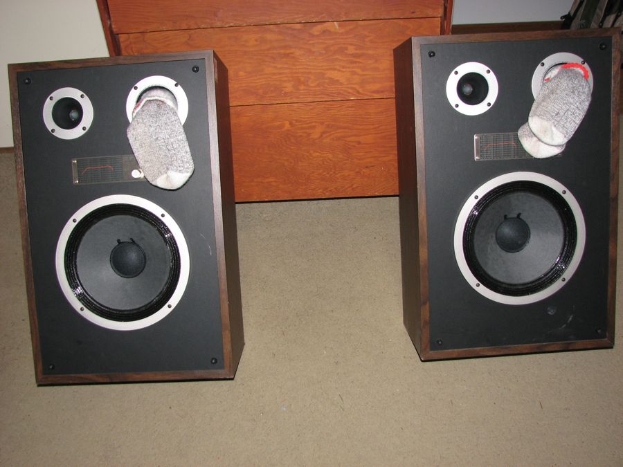

1) plug or stuff the port.
2) No port then add increasing amounts of acoustic stuffing fiberglass or polyfill>
3) Still not enough then add increasing amount of series resistance 0.5 - 2 ohms.
4) Still not enough and don't want to do step 3), then drill a few smaller holes in back panel and cover with a few layers of cloth.
heehee or we can get a load of more info from you and get our calculators out.😉
That was quick... Cal just posted that pic in another thread.
There are better things than socks. I like using low-medium density foam (i have lots), Same for the aperiodic ports in option 4. BTW 4/ is a more rigorous application of 1/. Probably be a good idea to seal the port.

Saw the pic and thought it fit the shoe so to speak.

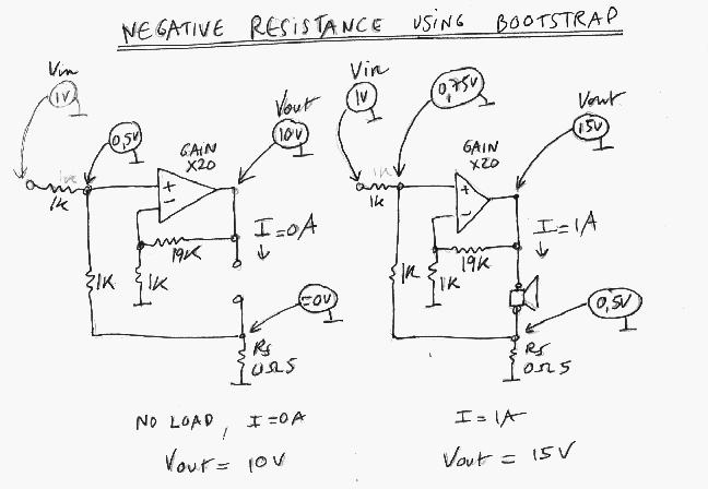

---Is there a way to increase electrical damping?---
Depends on your skills in electronics.
Using damping materials, you only increase the mechanical damping.
To control electrical damping, you have to go throught electrical ways.
Using a negative resistance amplifier, you can easily halve the Q of any driver.
An other way, only valid for closed boxes, is to use a notch or a "bell" correction if have a driver digital processor (Berhinger, BSS and the like).

Hi Sreten,
Negative resistance can be easy to implement.
I've been using this one for some time.
It needs a low impedance source.
I also experienced the Sokol adjustable transform for closed speakers.
Both worked well. I am currently using a digital processor with which Q of speakers can set at almost any value.
