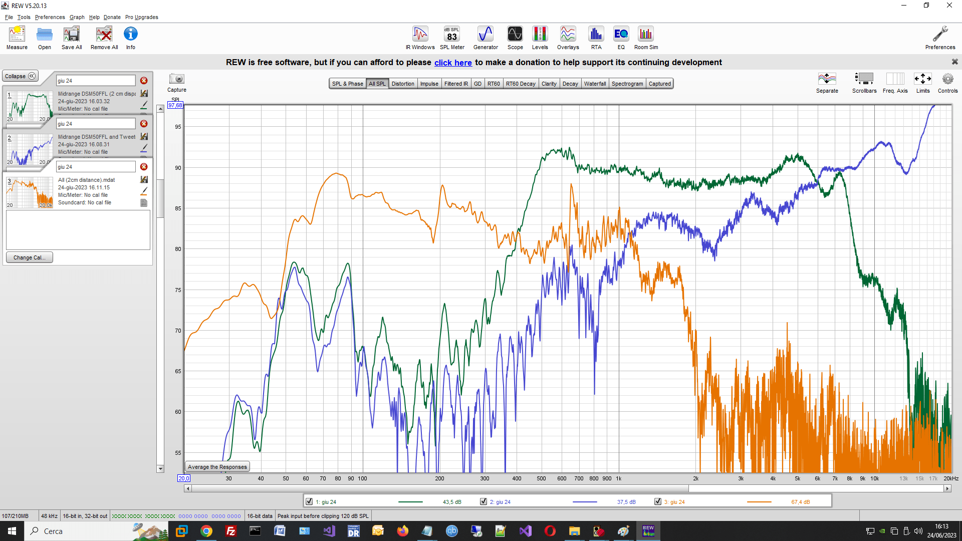

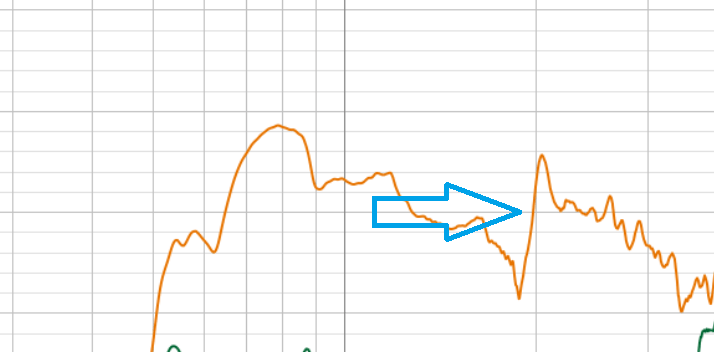

Today I have used for the first time Room EQ Wizard with my mic behringer ecm8000 to measure my old DIY speakers.
All drivers was measured at only 2 cm from mic.
After these measure I got confirmation that the crossover need an upgrade.

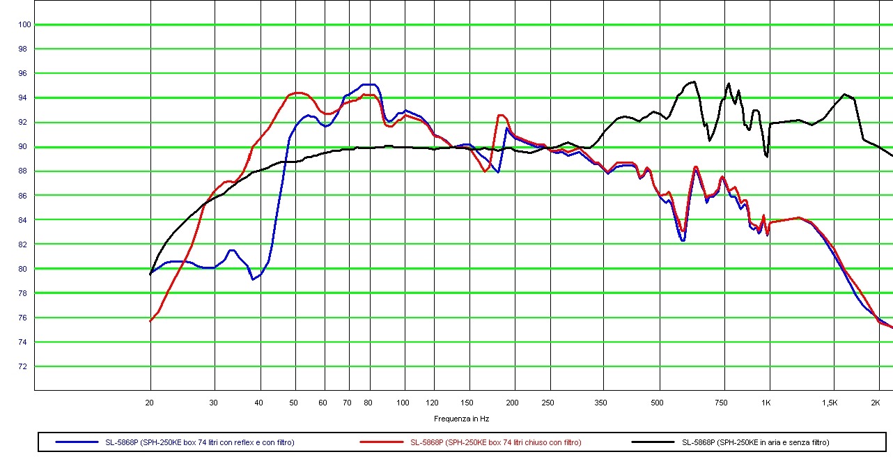

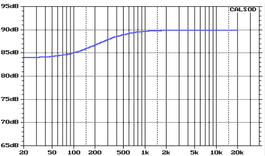

First is clear that the woofer is not 90 dB like the midrange and the tweeter (as usually happens).
There is a strange unstability at 170/200 Hz that happen only if the woofer is inside the box, but is not clear the cause.

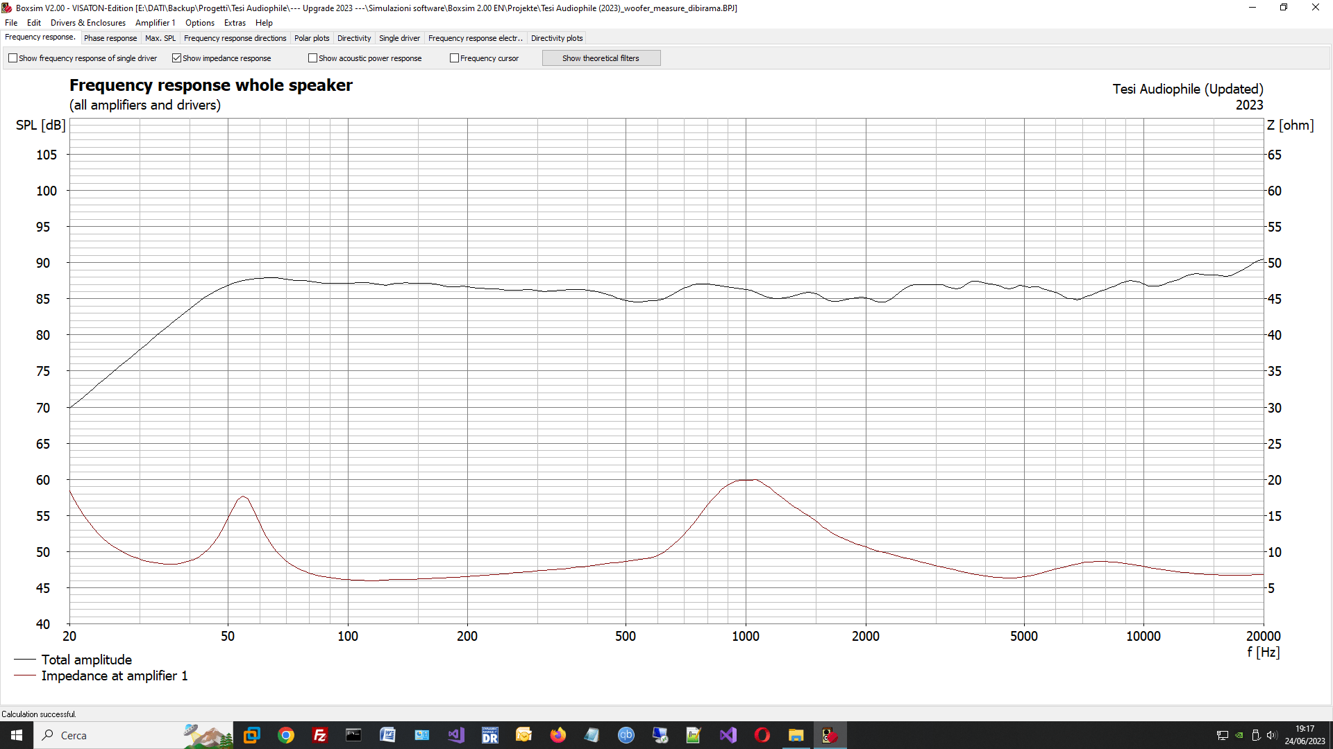

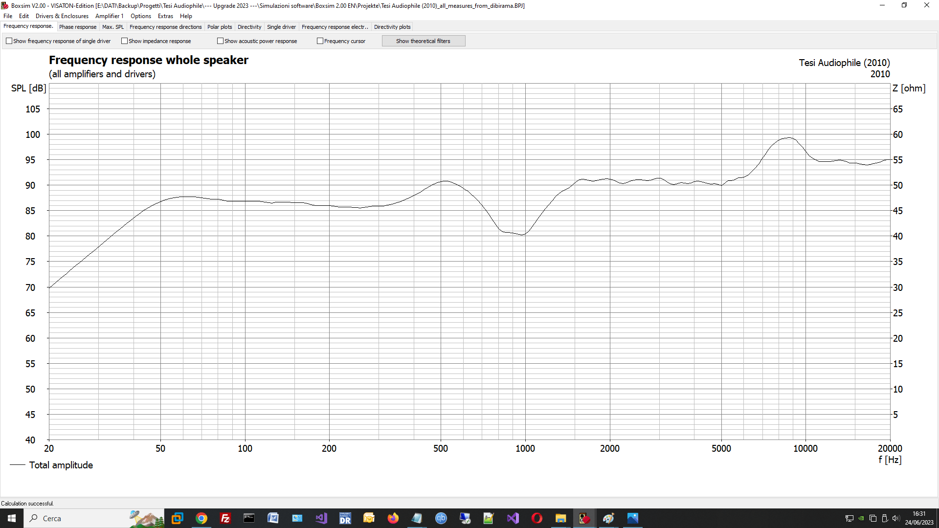

The measurements are very different from the simulation (2010) like I expeced but I don't sure how I can interpret these differences.
I have simulated a possible crossover update (2023) with more flat frequency response.
Any suggests ??
Thank you !!

Some suggestions :
  • Position the speaker as far from room surfaces as possible.
  • Measure all drivers with the same mic position and use gating (IR Windows in REW) to avoid early reflections. 6-10 ms will usually work.
  • Measure at 1 meter distance. Near-field measurements will get proximity effects and will not capture the effects of baffle diffraction.
  • Measure each driver individually. Disconnect the other drivers when measuring one of the drivers.
  • Use 1/6 oct smoothing on your measurements.
And please share which drivers you are using, and the current crossover schematic.

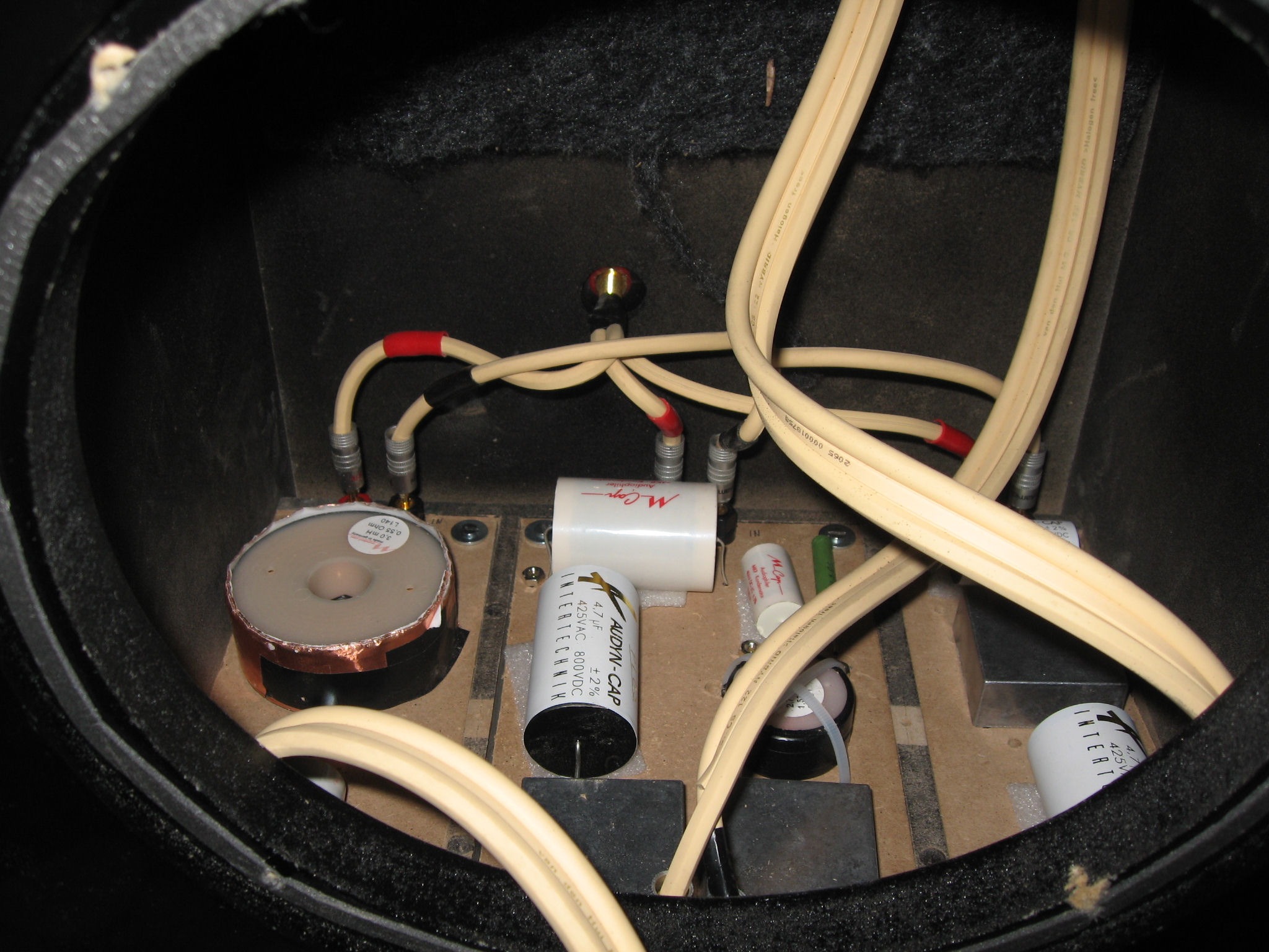

From your measurements it looks like you have a bass reflex box, so filling the entire volume is not a good idea. However, covering the crossover should not be a problem. Put in at least 5 cm damping on all internal surfaces, and measure again to see if that resonance at 200 Hz is reduced.

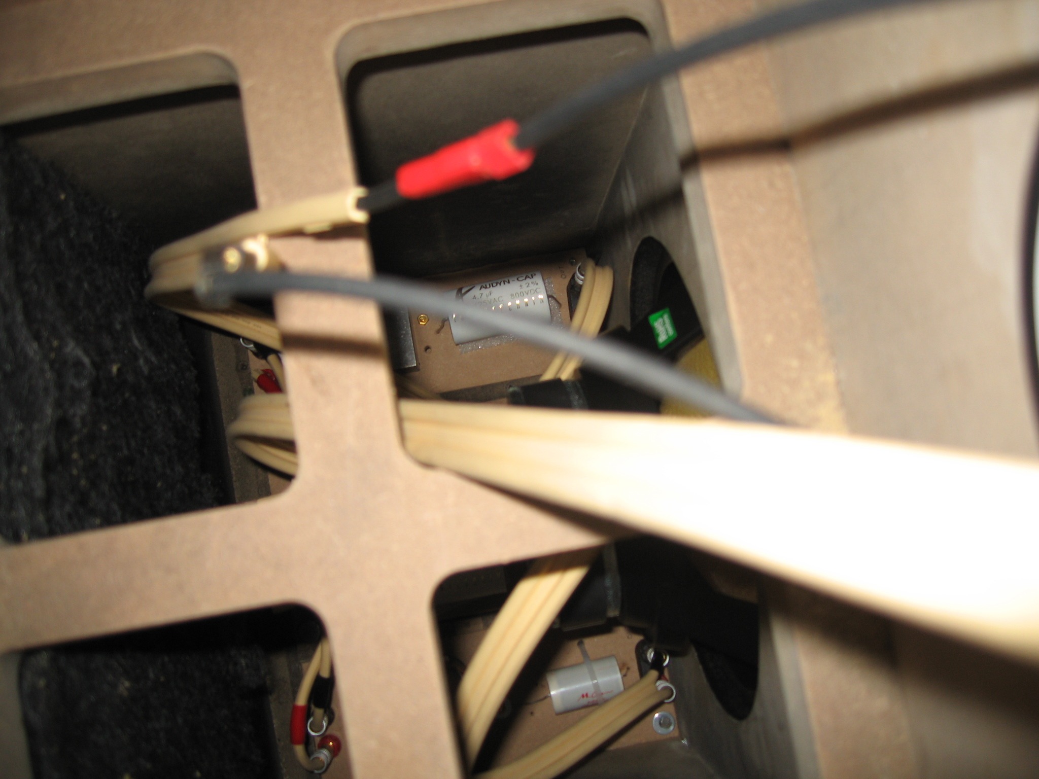

After ask to other this matherial:
https://www.audiokit.it/it/fonoassorbente-fonoassorbente/273201-sonofil-black-fonoassorbente.html
and they tell me that probably is not enough for this reason I would try to combine other matherial like this:
https://www.monacor.com/products/components/speaker-technology/diy-/mdm-2/
but is not clear to me what glue use to combine the two and fix it to the wood.
I thought of the classic 'Attack' that we have in Italy but I don't sure if is good this this purpose.
First of all, I'd take all those boards outside. And remove all the plug system, the less contacts, the better
Second, I'd put T-nuts for allowing a tighter hold of the speakers. And remove that foam around the perimeter of the woofer.
Third, yes, put better damping material. Use "mastice" (bostik)
