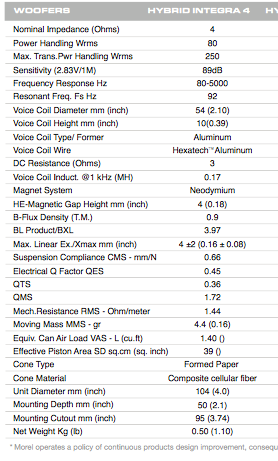

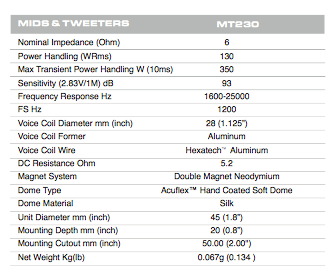

First is a 4" point source full range speaker with matched passive crossovers.
Morel Hybrid Integra 4":

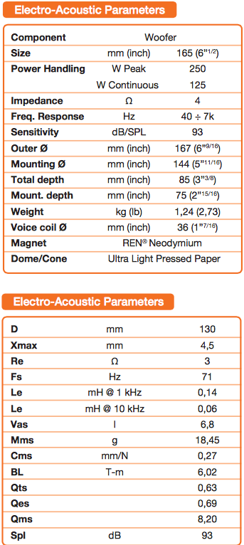

The bass would come from a pair of 6.5" Hertz MLK 1600 drivers:

I am new here and new to speaker building...
I have a couple pairs of speakers lying around leftover from a car audio project and I would really like to put them to use. They're of reasonably good quality in the car audio world but I have no idea how that translates to home use.
I'm wondering if there is anything that could be done with these speakers that might result in a decent home audio speaker?
If so any design suggestions or hints would be greatly appreciated!
I would like to use active/electronic cross overs because I also have the equipment for that available...unless that's a big mistake or not feasible in this environment?
First and foremost I guess though is whether these drivers stand a chance of working together...
I am willing to invest some time and money if these can be turned into a nice sounding pair of speakers. If its destined to be junk I will just sell them for someone to use in their car.
Thanks for any input or advice!!
Hi Jrhaze,
I'll just try get this ball rolling here, there are lots of ways you could go.
I'm not familiar with these drivers but if they sound good to you in a car I'd imagine they'd sound good for home use too.
Looks like you have all the parts you need (amps, crossovers etc) so why not build a suitable box for them and see how they go?
Do the manufacturers suggest a volume for the enclosures? Otherwise you can play around with a program like this, LinearTeam, to stick in the specs of the drivers and calculate some boxes for you.
