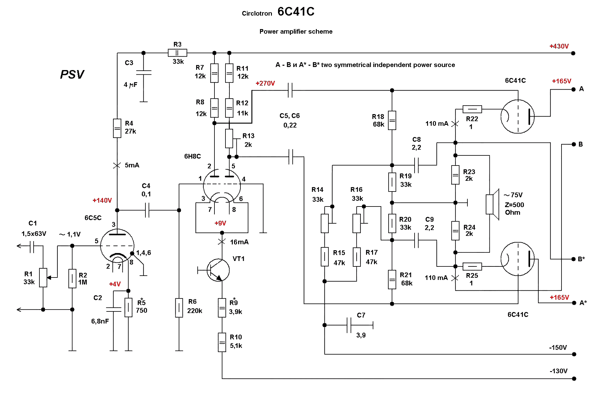

Can you share your amplifier circuit for AD 3800 AM?
What are his options?

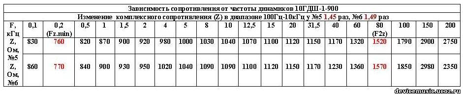

To AD 3800 AM: 800/576 = 1.39. Impedance increases rapidly.
Version the speaker of high-resistance 900 ohms at 1 kHz, impedance Z = 1,20-1,25Re.
Characteristics of the attachment.
(Point F2z is at 80 kHz!))))

The impedance-measurements. Would it take:
A sine-wave frequency-generator? Like a software-based on my PC.
A voltmeter in parallel with speaker, to help set voltage to 2,83 Volts for each measuringpoint.
An ampmeter in series to measure current for each measurepoint.
Would this do it?

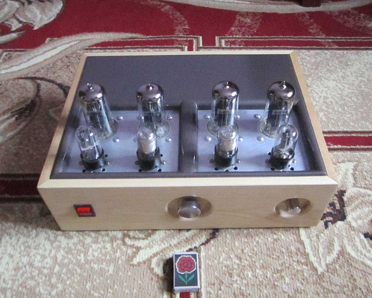

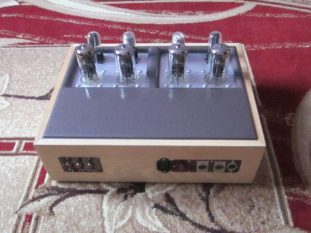

Cyclotron produced on tubes 6C41C, stereo.
Output power at load 500 Ohm (full-range speaker) 12 Вт
Band power 7Hz - 125 kHz
Slew rate of 55 V / us
Signal / background (noise) relative to the maximum output voltage of - 81 dB.
Dimensions (not including the height of tubes) 41x310x135 mm.

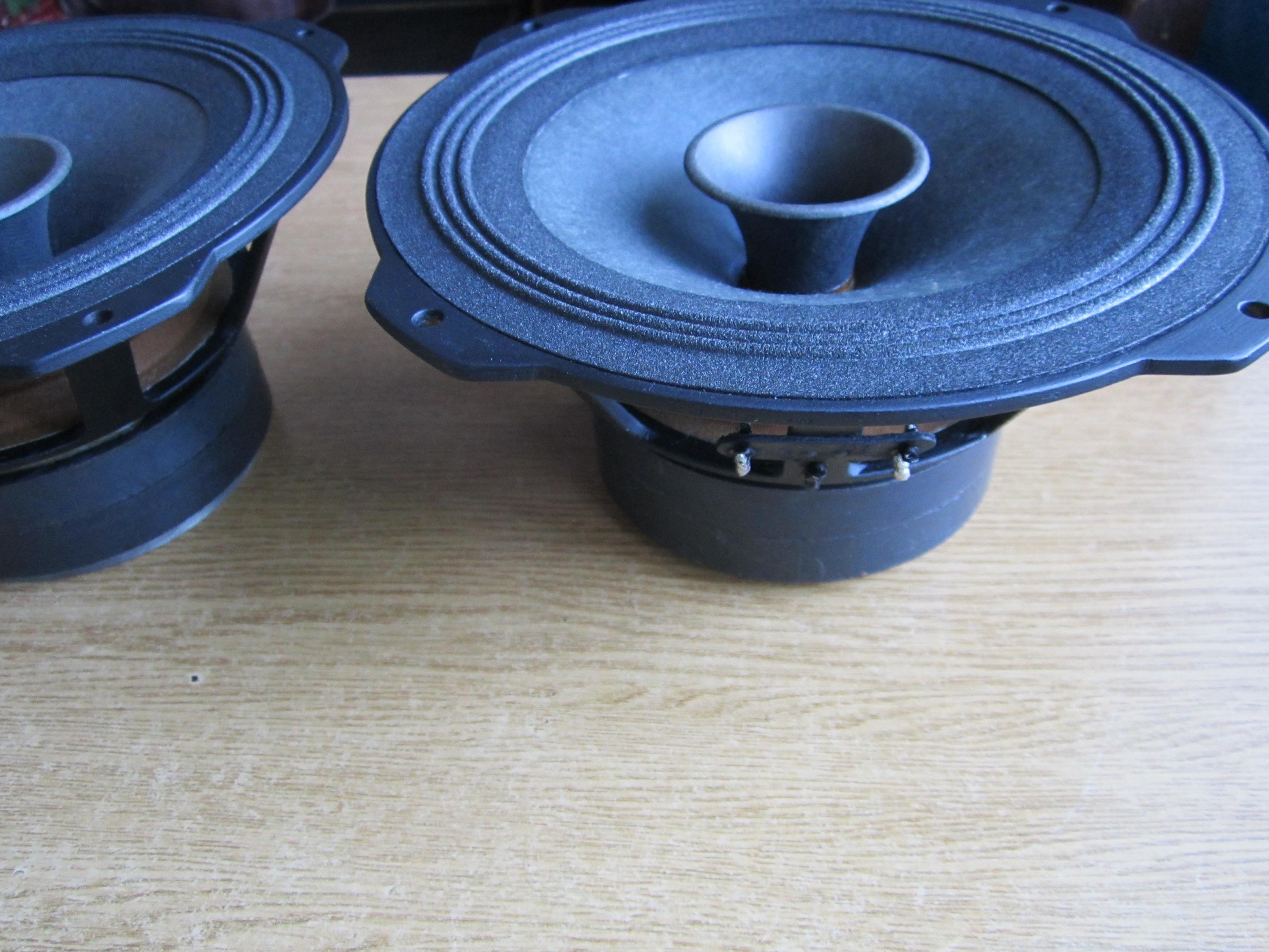

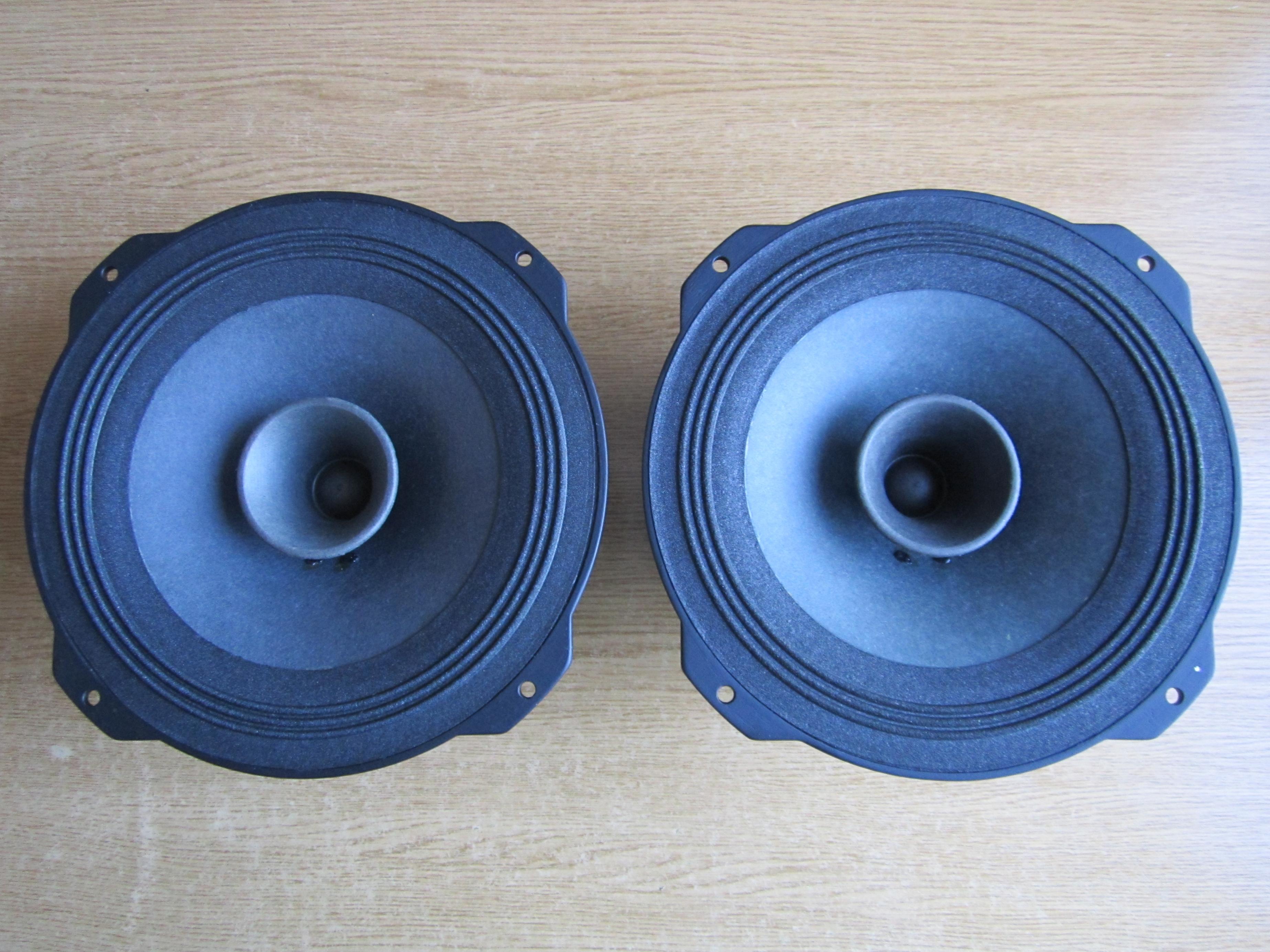

Voice coils are made to order, using special equipment, according to my drawings.
If You notice, these speakers have very low inductance. It is much lower than that of their counterparts of low resistance.
I am interested in such speakers. Could you write where I can order them? I speak Russian, so it is not the problem. But since it it english language forum let's use it.
You can order them from me. Several couples are in Russia and other countries.

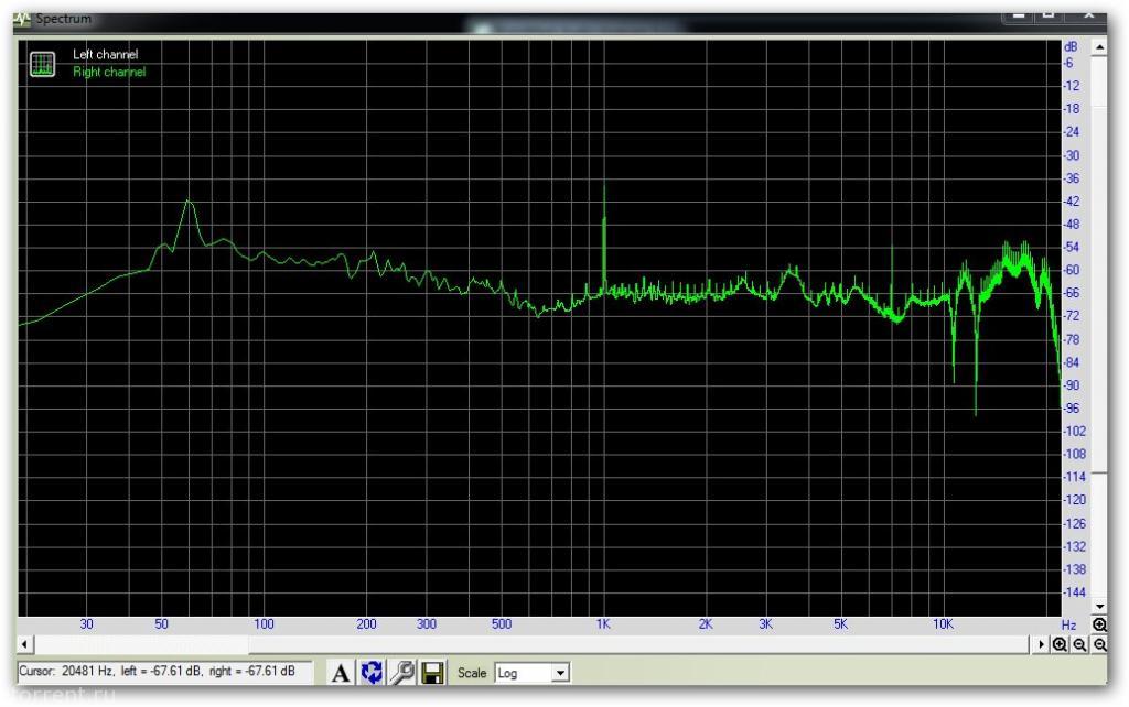

One of the users measured frequency response (the attachment).
On an example of resistance of 1000 ohm speakers.
Measuring system is not outstanding. But in the first approximation gives opportunity to see in the high frequency characteristics.
As you can see, 500 Hz and 20 kHz are played on the same average level.
The attachment photo next pair of speakers nominal impedance of 2000 ohms.
Will be measured more sophisticated measuring complex.

I would like to ask about Price for a pair of 1k Ohm speakers to Denmark?
Which pre-build speaker-units are they based on?
The cost of a pair of speakers 1 kOhm - 360 USD. This resistance (1 kOhm) basic. As is consistent with the majority of tubes with a low internal resistance.
Costs for packaging and shipment to the United States 68, Russia - 55, Denmark - 52 USD . Speakers are made in pairs, with similar parameters.
Each speaker has its own number. Thiele-Small parameters are applied to the description and photos. It's all agreed with the customer prior to shipment.
