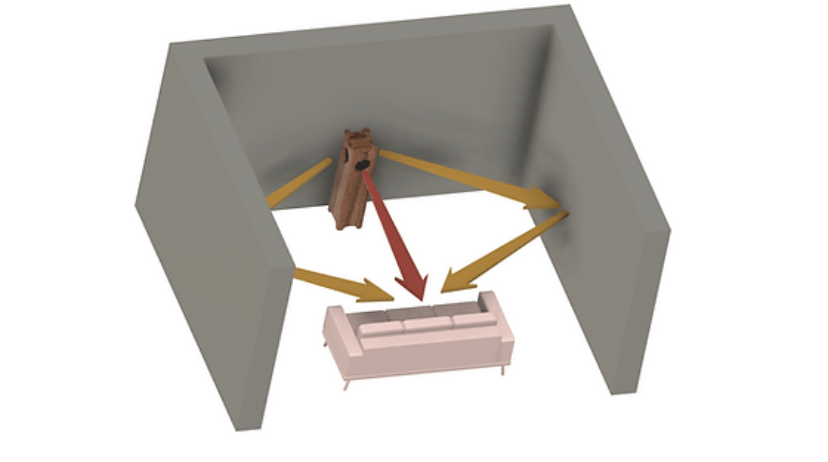

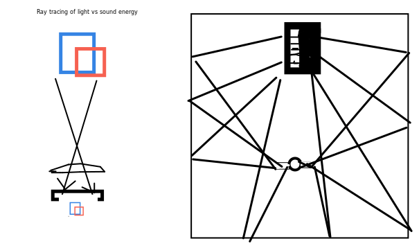

The path sound takes, reflecting down the room and down a narrow canal is just complex. A rough diagram illustrates. The black and white item is supposed to be a piano. This is just a 2 D diagram I can imagine what the walls and ceiling do to the sound. Sound also travels directly from the piano to the ear - forgot to diagram that part, but from different points on the piano. How to record that, with 1000 microphones and play it back 1000 spherical corresponding speakers? Truly surround sound.
Well of course there are reflections from the walls but it is super diffused. If no light reflection from walls, many room would be very dark ;-)
concept makes sense in some way.I was thinking about that but will not work for ordinary stereo recordings. For standart industry stereo records this concept works incredibly well. I would say probably i get more joy from listening to this than to normal stereo

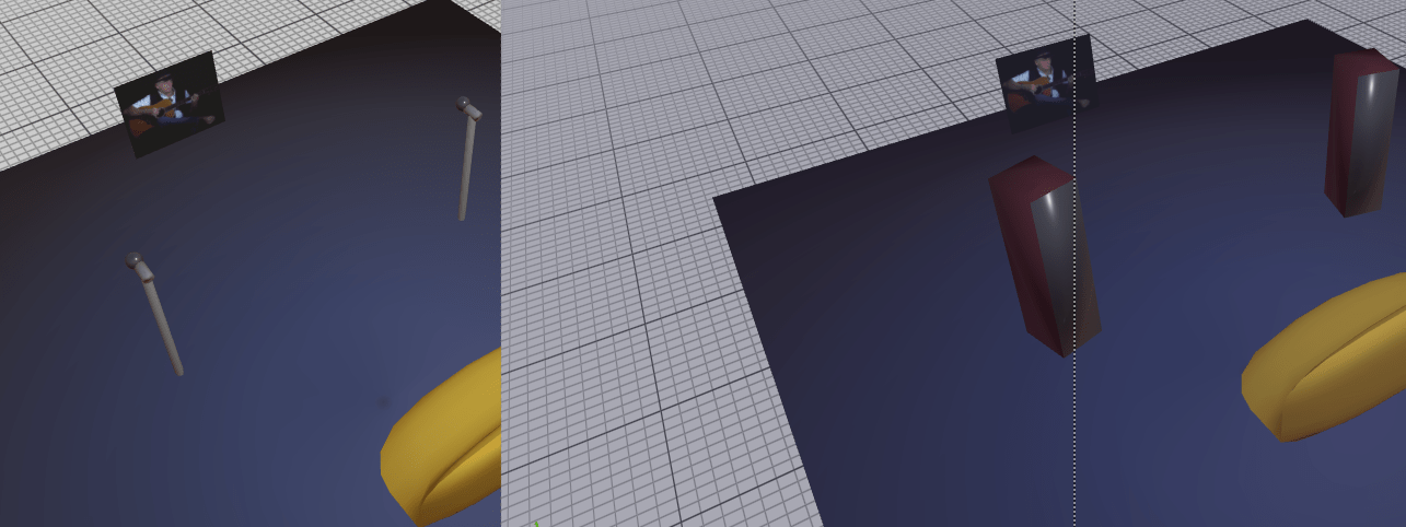

What's wrong with this picture? Place the microphones where the speakers would be, record, and then play back the music through the speakers with the speakers in the same position as the microphones, facing the other way. Or better still, use the speakers as microphones, turned towards the guitar player, record the output, and play back through the same speakers.
It neither reflects typical acoustic sources outside and above the mics or captures the majority of intraural delays, head shadowing etc. critical to our localization mechanisms.
All the sounds reaching the microphones are captured, direct and reflected. If you place one ear where the microphone is, you would hear what the microphone hears. With stereo, though, yes, head shadowing and the other stuff will happen.

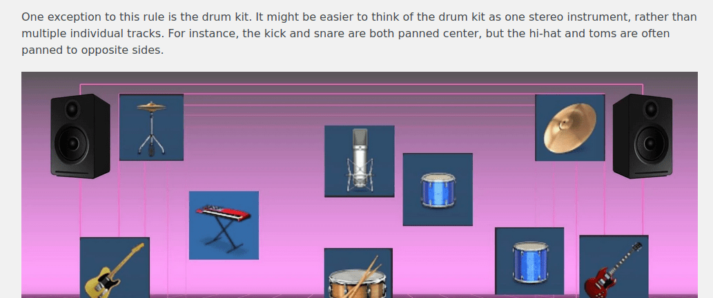

That said, I was rather surprised at the way studio mixes are done, basically cutting and pasting sounds all over the room, smearing synthesizers across the room in even volumes from left to right. This is not reality, it is fantasy, it's special effects or should I say spatial effects(!)
They cut the drum kit to pieces? I suspected as much but really...I am getting a headache looking at the picture.
https://www.masteringthemix.com/blogs/learn/guide-to-panning-and-stereo-width
The reproduction of sounds from a guitar sound uncannily real even on a simple full range speaker. However, to reproduce what I hear from a guitar, in a room, with the reflections and so on, well, I don't listen to string quartets and the like, I listen to exclusively recorded and processed music.

The first sentence depends entirely on the mic's pickup pattern, which can vary strongly with frequency. Omni or fig-8 mics tend to be the most consistent in terms of maintaining their pattern across the range, but even those start to exhibit nonlinearities in the top octave or two, as the wavelength becomes comparable in size to the mic.
The second sentence is so far from the truth that I don't have enough time to explain it right now. Needless to say that ears+brain has a very different set of mechanical and electrical signal processing to that of a mic capsule + preamp. A binaural dummy head gets you closer, but those recordings tend only to "work" well reproduced with headphones.
I'm sorry to say - but that's mainly cause you have no idea how recording and mixing is working.
You probably never heared a natural drumset from 3m distance. You will never hear this sound on a record and also never on stage live. No way.
Cause it's - lame. It doesn't sound anything as you are used to what it should sound! The Kick is silent and has no power at all (the first thing you mic on a drumset, even more important as the overheads in small rooms). Toms are to silent. Snares to thin. Cymbals often way to lound (depends if the drummer really knows what he is doing ;-)). And everything comes just from one point - so it overlays and get's washed.
I have rehearse today - should I post a short soundfile?
So - you record a drumset from close. Similar to what you hear when directly standing in front of it or what the drummer hears at the drumseat. At this position the drumset is BIG, sometimes even around you. It uses the whole spectrum from left to right of imaging. So you use a stereo microphone and get a wide image of the drumkit - which sounds cool and separates the instruments to hear them better.
You need to strengthen the shells. You need a signal without room sound and low bleed from the other drums (a drumset is a set of many instruments which are often quite different in their behaviour)! So you have to come close with your microphones. The shells don't sound anything as they should and you need to modify (eq) the signal. Then you have to listen where the shell you want to reinforce sits in the stereo mix from the overheads and put your close mic there with panning - otherwise you will hear 2 locations for a drum and everything get's confused. And when you are careful you even delay the close mic so timing fits to the received sound in the overheads.
Of course you have bleed between the instruments and microphones of the drumset. For some drums (kick, snare) you even use more then 1 microphone to get the whole spectrum of the drum. You use spot mics for cymbals which are not loud enough or very important and need to be clearly heard. You use room mics to get the impression of - room. Often 2-3 sets of room mics for different purposes.
So you end up with 10-24 microphones for the drumset. And when everything is done perfectly right (which is not that easy as this supershort summary maybe gives a hint 🤓) people say "Wow, that's a good and natural soundig drumset". It's sound is completely designed during recording. Cause nobody wants to hear a natural drumset.
You know the drumsound of Metallica St. Anger? A very brave project - cause the drumsound was kept unusal natural. Still with plenty of mics but closer to what an amplified drumset would sound in a rehearsal room. You know the reactions of the fans? 😏 They will not repeat this experiment ...
There are mic techniques with less microphones like "Glyn Johns technique" with 3-4 microphones what they used in times of the Beatles. With a great set and room this can sound cool too - but is in no means natural! The stereo panorama you get is far from a real drumset, kickdrum of course enforced. Floor tom is amplified to much. It's always a compromise ...
p.s.: I didn't write about the most important things - a good drummer, a great tuned instrument and a perfect recording room is of course needed to start with 🤓
