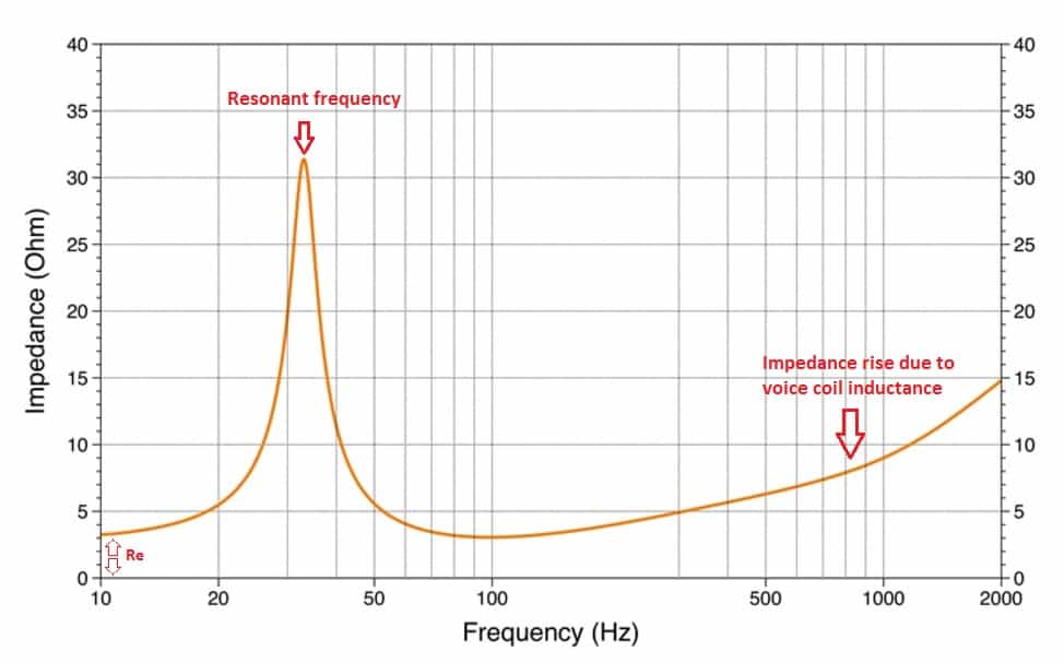

When you are using dmm to measure speaker, you are using dc current, not ac current. You are measuring at zero Hz. Result is much lower value.
To obtain correct speaker impedance, you have to use ac signal generator and millivoltmeter. You can use rew, or purchase dats.
Btw, speaker impedance while defined at lower point, can be quite high at Fs. See attached typical woofer.
