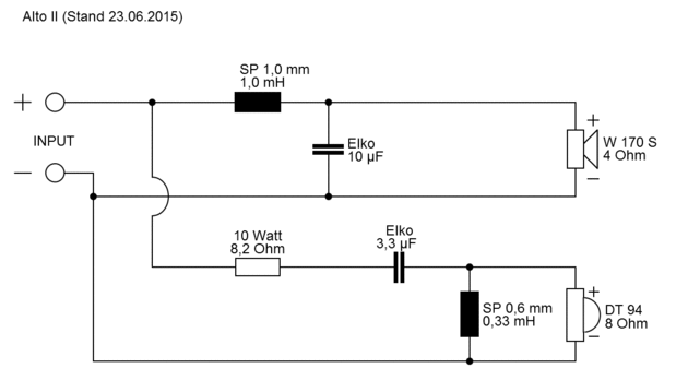

I've just finished making some Visaton Alto II speakers (ALTO II)
They sound nice but one speaker is significantly quieter than the other one. The resistance across the input terminals of the speaker is 12 ohms in the quiet one and 5 in the louder one.
Is this normal? Could it be cause by using slightly different speaker wire, or different hand soldering on the cross over or something?
Any suggestion welcome!

Looks like you might have 8.2R in series with the woofer to me! That would give 12 ohms. 😱
Be careful here, and check your wiring. Tweeters can fry...

Hi everyone - think I've got it fixed...the terminals now read 4 ohms anyway.
The problem seemed to be where the negative input, woofer and tweeter terminals joined. I noticed a bit of corrosion on the copper wire of one of these joins, which then snapped off as I was looking :S The multimetmer also showed no conductivity from the -ve input (which can't have been right, there was sound coming out!).
Anyway, soldered all three off, exposed new copped and soldered back on, and the terminals now read 4 ohms!

2) Perhaps I didn't tin the arm of the 0.33 mH inductor properly first time round, and maybe there was plastic coating left on it.
