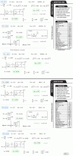

Alright, I've been doing some reading, and some fiddlin', so I now know just enough to be vagrently stupid and dangerous, haha. I just ran the WinISD program for both the drivers listed, and I've got two setups "designed".
8.68x6.97x10.41 (with .25" boards) for the 8" driver. Granted, with an EBP of 66.1, I'm not sure a sealed enclosure would actually be best here, suggestions? (vb = 8.7L to get a Qtc of .71)
26.57x16x10.3 (with .25" boards) for the 10" driver. (vb = 63.1L to get a Qtc of .71 (which seems very high...), EBP = 52.4)
Now, compared to the 10", the 8" in a sealed enclosure is -3d at 30hz (~-10 as opposed to ~-7)
About how much of a difference is that going to be in a small room?
Picture:
b :)
I would definitely go with the 70w plate amp at least. It also more than likely has equalization in it, which may end up helping the 10" get a little lower.
Internal volume is calculated using the inner dimensions of the enclosure, from which you should definitely factor in the woofer's volume, as well as the plate amp's volume, as it's most likely 3 or 4 inches thick recessed inside the box. If you end up using a ported design, the volume of the port should also be subtracted.
Personally, I tend to find that my ported designs end up being more pleasing (read: more efficient and tunable) in the end, and as such I haven't built a sealed sub cabinet in about 10 years or so. It gives you the ability to tune the enclosure and if done properly (experiment with WinISD) you can tune that box and get that woofer down a little lower.
bjorno: Many thanks for the sheet comparison. Now that I see all the numbers and formulas it makes more sense.
DrDyna: I would consider a ported enclosure, but the more I play with volumes, the more I realize I don't have the volume for a proper ported enclosure, as this is going in a dorm room (specifically on isolating mounts on the bottom shelf of a bookshelf). Maybe someday I'll have the room for a proper ported system, but by then I hopefully won't be using a pair of av30's as theater speakers, haha.
