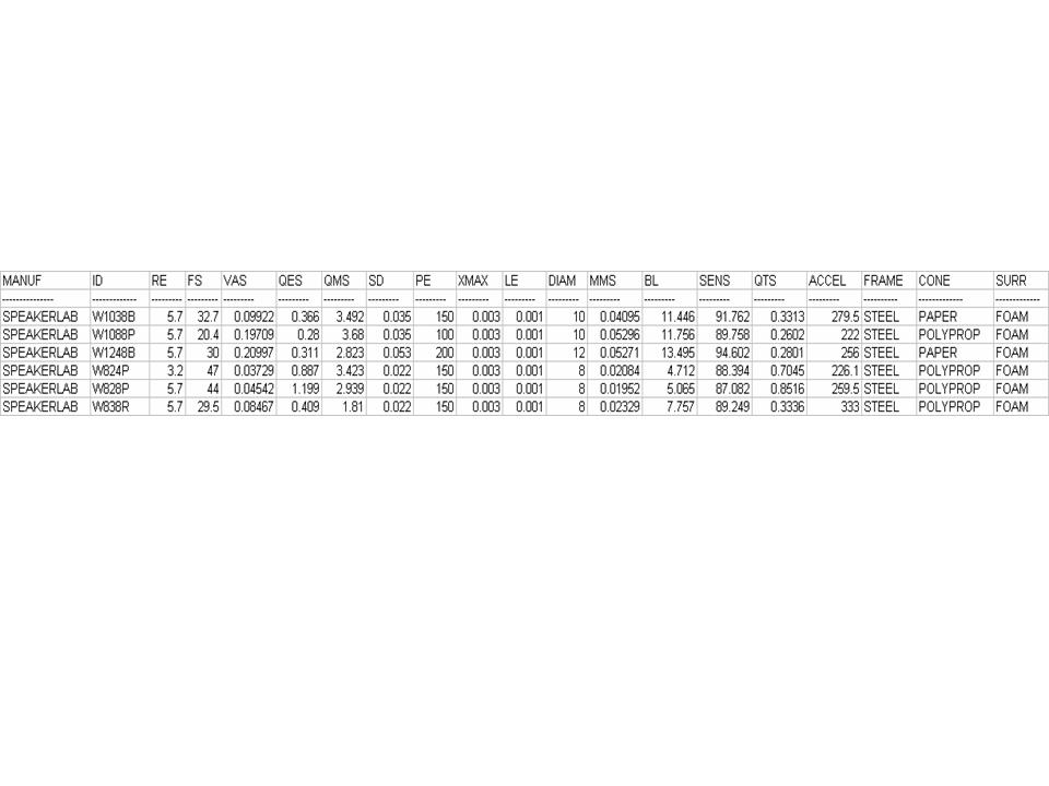

Found a few T/S parameters for these Speakerlab drivers.
Recone seems about $75 per woofer.
