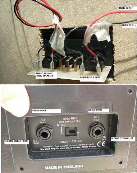

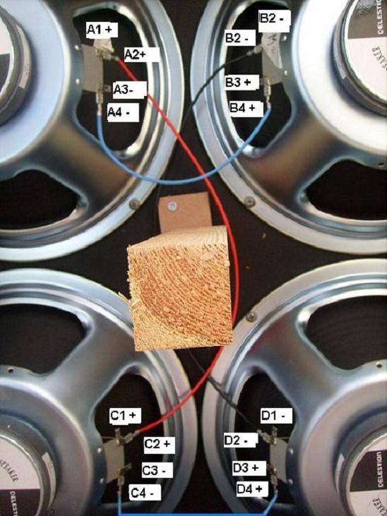

Hello please can someone help me - i have no speaker wiring experience and have found what i want on the net but i don't know how to do it. Please could somebody tell me how to wire a Mono/Stereo 412 cabinet with 8 ohm G12's in it. I have attached a wiring diagram which i have found on the net and a picture of my amp with labels and + and - . I have a switch to change from mono - stereo which i think was off a 1960cab - I am wiring a AVT 8 ohm cab which was just mono when bought.

Please can someone instruct me

Are you planning to get rid of the switch and just run it as a 4 speaker mono? If so that's easy. If you still want stereo and can get rid of the switch, that's easy too.
The letter/number system you have used appears redundant. ie: A1+ and A2+ are the same thing. Each terminal can be identified by only one figure.

Sorry I have a switch which switches from mono to stereo like the 1960 amps but the numbers on the back would be different and i understand that.
Is it possible to wire it up so it can be switchable like in the first diagram of the website.
Pic attached of switch
