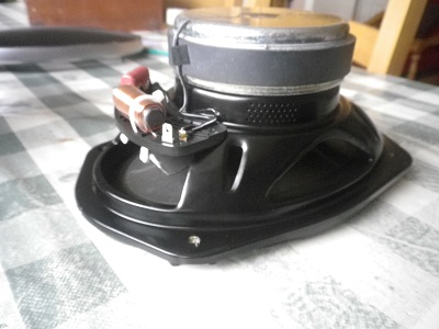

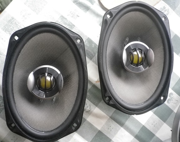

Here is some info on the speakers here...Amazon.com: PIONEER TS-D6902R 2 WAY 6X9 360W CAR SPEAKERS ( PAIR ): Car Electronics
It does as Generic George suspected have a crossover.
"The built-in -12dB/Octave HPF and LPF crossover improves the transition from mid to high frequency, for a smoother mid-range to tweeter response"

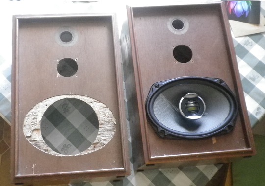

I atach some images of my efforts !

Just buy some half decent used used speakers compared to the garbage
you have. Adding a driver won't help. Ignore utterly stupid power ratings.
Your Technics will be be fine with any half decent used hifi speakers.
rgds, sreten.
Put the car speakers back in a car, where they belong.
TBH, for car speakers they look quite good.

...i am thinking to add a 6" speaker to the bookshelf...
Not sharing the same cavity. Then they will modulate each other (push on each other, with poor results since they are not identical).
You can:
1) Just live with what you have.
2) Take your existing cabinets, coat the insides with anti-vibration goop (auto body undercoat might do, though I'm sure others can suggest better materials), and stuff the cabinets to make them seem a bit bigger to the woofers and absorb midrange frequencies so they don't reflect back out through the woofer cone (1 pound of fiberglass per cubic foot is good. Forget about pillow stuffing. And again, others may have no doubt better suggestions. You can find a BUNCH more information about this and other topics here:
Loudspeaker Design Cookbook 7th Edition Book 500-035
3) Buy some real hifi drivers and follow an existing kit design. Quite true you can get some pretty inexpensive stuff which is very good.

The sound you describe for these speakers seems plausible. Many car two ways use pod style tweeters that seem to cause issues in the lower treble due to their shape, have small voice coils, and cheap plastic cones that sound that way. They are displaced in time from the woofer cone which also often seems to forget about the upper midrange.
OR, on Pioneer's site, it says the above but also says "High-Quality Passive Crossover Network (Woofer, LPF: -6 dB; Tweeter, HPF: -12 dB)"
Personally, without seeing an external crossover box anywhere, I don't believe any of this, especially at this price. Likelier a marketing mistake. I'd bet $10 there is just a capacitor stuck under the tweeter housing.
And, -6 dB does not work on woofers-the inductor's impedance is partly offset by the rising impedance of the woofer and you get more like -3 dB.
-12 dB on tweeters often doesn't work perfectly either, since the resonance of these tiny tweeters is high up, and the resonance impedance peak interferes with the crossover.
Certainly a -6 dB capacitor NEVER works as it should due to the impedances of the tweeters. Plus, yes, the tweeter housing does interfere and cause peaking. Just a cap on the tweeter always made a phase interference with the woofer, resulting in a peak and dip that moved around with different cap sizes but didn't go away. This was with many coaxes of various sizes from different factories that I tested over the years. An off-tuned 12 dB network could get things much better, but car speakers are just far from perfect until you get to very expensive ones. That doesn't mean they are bad, just that you can get better results with home drivers of a similar expense.

Running the turntable into a line input would have needed very
high volume knob settings. It should be OK / normal now.
The car drivers need a far bigger box and the results will
never match a half decent used pair of hifi speakers IMO.
