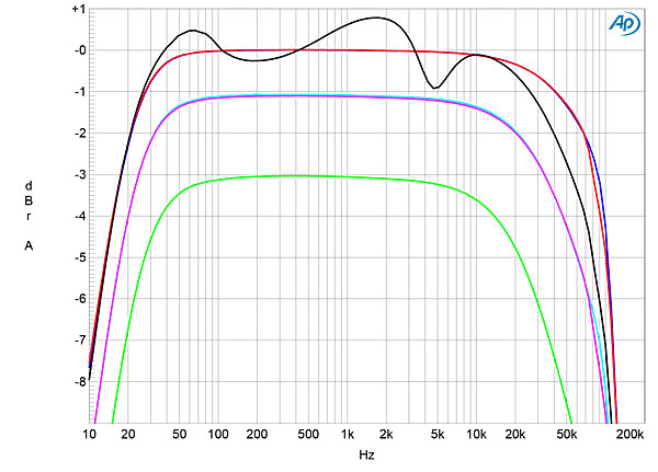

Based on solid prior evidence. Go look at the FR of any amplifier with highist Rout on the simulated complex load one can get a very good idea how big the effect is.
Everharmincs has always seemed to lean on measurements… here that we have (mosty) measurements guiding the answer, he wants a listening test. Guess one can never be right?
Here the FR of an amp with similar Rout to the stereo ACA.

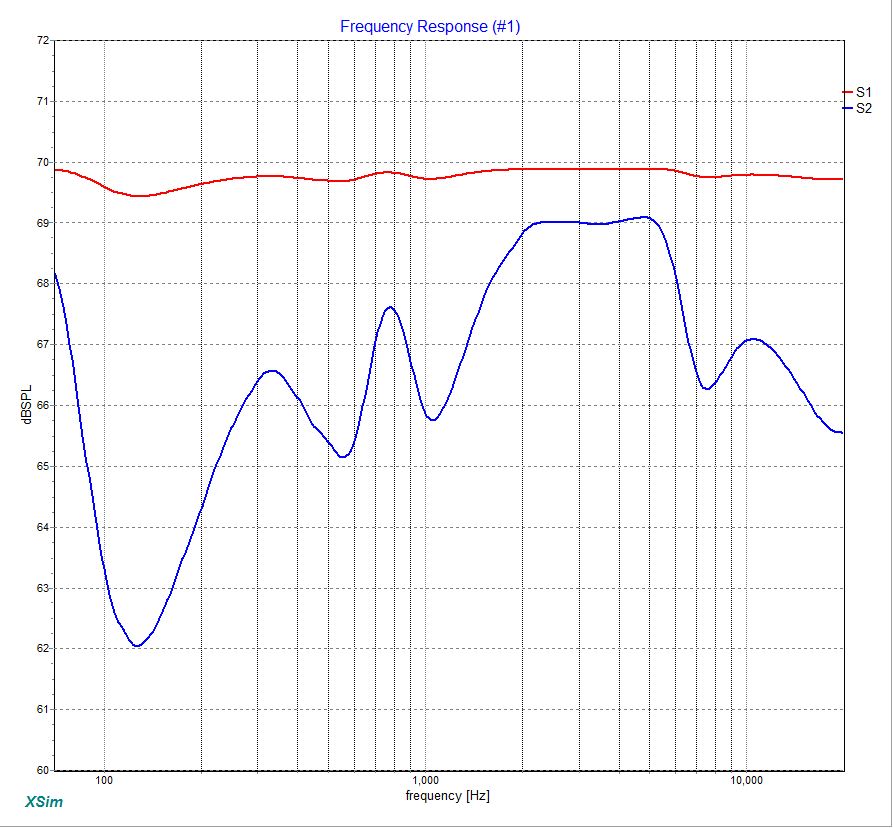

Showing the Forte III example with a selection of Zo. Red with 0.25 ohms, in a system without defects this magnitude of variations might be audible.. Blue with 3 ohms, attainable and less likely not to be heard.
What is it exactly that we're supposed to be showing?
