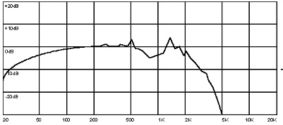

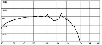

Alas, I do not know the price of the Volts, but you can check that from contacting the distributors listed on their website. Here is the frequency response for the 3823:

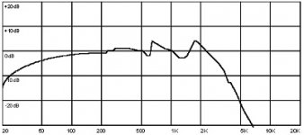

Finally, Volt also has an 18" speaker, the 4504, which is also rated at 96 dB. We can expect that to be an honest 96 dB like it's 15" brother, therefore equivalent to others' 99 dB. The thing about this speaker is that it has an incredible excursion-for a PA speaker-of (+ or -) 10 mm linear. It can go (+ or -) 25 mm mechanical-two inches throw!! Unheard of for a PA speaker. With a throw at least twice what other PA speakers put out, the 4504 should output 6 dB more deep bass than other PA speakers with half the excursion.
If these specs are anywhere near accurate, what a monster the 4504 must be!!
http://www.voltloudspeakers.co.uk/About_Us/about_us.html
Click on "Loudspeakers", then "Radial", then picture.
Graph below.
Let me emphasize that I have never used the Volts, so I cannot say for sure what their quality is. But they look very good, their specs are consistent with each other-which other manufacturers' are not-and they have some interesting design ideas.
I hope I given you some possible options for investigation.
