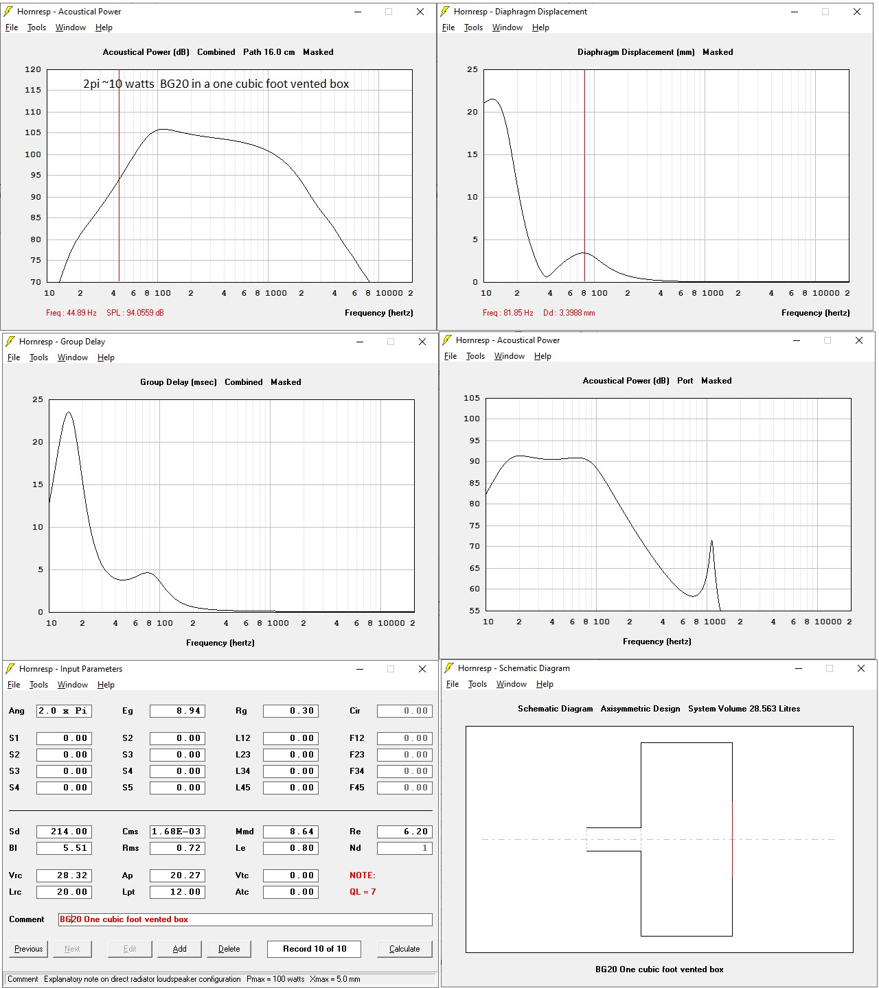

Here's a little sealed box for you and BG20. 18-20 liters with 450uF series capacitor for a so called "3rd order box". I'll check later to see what can be done for vented box.
Power handling is around 10 watts at its maximum excursion frequency
of ~ 75Hz.
BG20's whizzer can be removed and then its response looks more like their expensive B200.
I'm used to loud things so take my comments on dynamic range with a grain of salt.
a one cubic foot vented box for BG20 will have some peaking but may sound pretty good - especially away from room boundaries.
you could stuff the port, etc. to taste

Cool - pi-align is awfully good. I'd rather 36.67 than 42 liter. Hornresp thinks they're essentially the same but with a teensy award with group delay to the smaller/lower tuned box

Remembered some T/S measuring info from way back when that allowed me to 'tighten up' the alignment over trying to work it in HR, which limits it to 1 Hz increments, so for the record it's 38.2 L/28.5 Hz Fb.
Simple five-quarter square foot closed box, stuffed with some polyester wadding will do great job with BG20.
