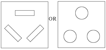

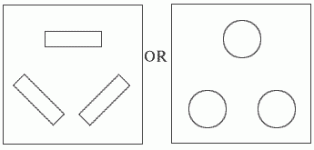

Ok, after pricing quality speaker stands, I have decided to build my own. I am thinking of using 3/4" think Oak plywood left over from building my entertainment center for the base and platform. This will be good since it will match my decor and please the wife 😉 . For the "posts" that run between the base and speaker platform, I have two options. I can either use 3 pieces of 1"x2" Oak facing, cut to length and set in a triangular configuration. Or, I can use 3 pieces of PVC painted a metallic silver or black or whatever. I have these following questions:
1. Will oak be ok to use or will it be too resonate?
2. If I use PVC for the posts, how will I attach them to the base and platform peices?
3. What is the point of filling the PVC with sand? To make them more stable?
4. What are the purpose of spikes on the base?
5. How do you determine the proper height for your rear surround speakers?(This is what I'm building the stands for. After determining what height they need to be set at, then I'll know how tall t make the stands.)
Attached is a diagram of how the posts would be laid out on the base using first the oak facing and second the PVC.
That should about do it. Any help you can give me will me greatly appreciated.

First, I'm not sure about oak, I'd use it, but then again, I don't go for the overly esoteric ideas.
Secondly for attaching PVC you have a couple of choices depending upon the amount of work you want/are capable of doing. You could route a dado or cutout for the ends to sit in and glue them to the wood. You could glue a blank into the ends of the PVC and screw from the other side into them. (Position the screws so that the speaker sitting on top will hide them or counter-sink them and use wood plugs to cover them) One final thought would be to purchase three lengths of all-thread and bolt the two plates to each other with the all-threads inside each PVC pipe.
As to filling with sand, yes it makes it more stable and it also eliminates the resonance chambers within the PVC pipes as well. (For fun just take the pieces and heft them without sand, pretty darn light, aren't they?)
The spikes, if I remember correctly, are used to keep the speakers from setting up resonances in the floor. I'm not sure on this, so don't quote me.
As for height, since they're surround, its not that big a factor, but I'd say the higher the better. My current ones are a little below ear level, and I end up localizing surround effects right to the speaker closest. (If its going to both) My next placement will put them up higher so that I can, hopefully, reduce the localization issue.
On a personal note, I kind-of like the flat pieces the way you have them laid out. I'm assuming the support pieces will be solid oak by the way, otherwise you'll be staring at the ugly plywood edges. (Even edge banding isn't much better, it'll still stick out)
Hope this helps you some!
>>It doesn't matter. Use anything. No one has ever heard a speaker stand resonating and no one ever will.
>>Get flanges that fit the pipe, glue the flanges to the pipe, and screw the flanges to the wood. Don't even think about epoxy on PVC. It won't bond. Use PVC cement.
>> It will add weight. Whether it adds stability depends on what the stand is sitting on.
>> One of the great audio mysteries. When used on speaker stands they do two things: impress folks who have "the religion", and poke through carpet to the hard floor below to add stability. When used on floor sitting speakers, some claim spikes will couple the speakers to the floor, others claim they will isolate speakers from the floor. I think they lift a speaker off the floor so that you can have one more vibrating surface (the bottom of the speaker) coupled to the air.
>> Schedule 40 PVC comes in grey and white (with red lettering all over it). Paint won't properly stick for the same reason epoxy won't bond. You can get paint to stick by first wiping the PVC with a rag soaked in vinegar. Let the pipe dry then paint it.

Well, I see I'm a little late to offer more help, as you've purchased everything, but that's not to worry about. About the only things I was going to say were: a) HD should have had some, I've purchased from them in the past. (Heck, even Sears hardware has all-thread!) b) I wouldn't epoxy the nuts, I'd just use lock-nuts (Not lock washers) The lock-nuts will do wonders, the lock-washers, won't, trust me... I have a table saw held to its mobile base with lock washers, and it comes loose, a chop saw with lock-nuts, and it takes quite an effort just to get the nuts off by hand!!
Oh, by the way, you mentioned a concern of bowing on the pipes... How much weight are you putting on these things?? (Not to mention how thin are the pipes you're using?) A 1 1/2" pipe has enough compressive strength to hold over 100lbs!!! (If you're using three, you should be able to sit on it without any bowing!!!)
As for the edging, All you really need is a saw that can cut an accurate 45 degree miter, not that difficult. (If you're in the NE Ohio area, you're welcome to come over use some of my tools...) Let us know how it comes out!
