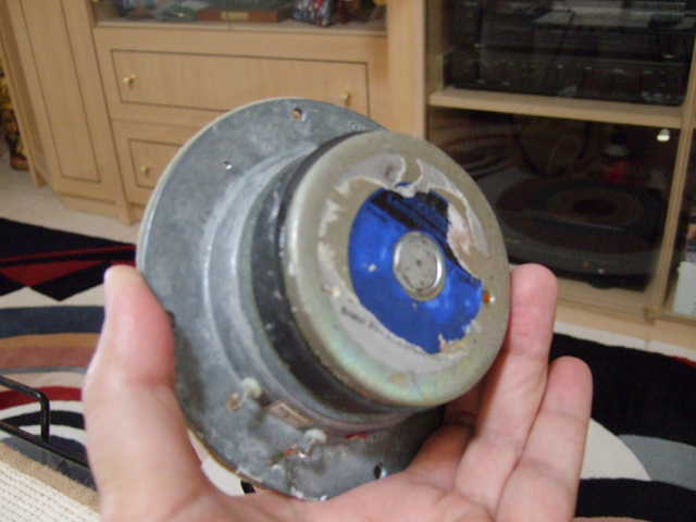

Thanks...What happens if the driver has a sealed back ? Is the back pressure (any more) constant; (or) independent of the box ? The original driver in my TL speakers was a Radford (actually made by Goodman) That midrange featured a sealed back. It looked almost like a second skin behind the cone....stiff Aluminum...very shallow. The Morel EM1308 is also a closed back device. I chose it because I had to mount it in the same chamber as the woofer.

Thanks again for your technical insight. I didn't know of many quality midrange drivers that featured sealed backs. The Fs of the Morel EM1308 (a sealed back unit) is 320Hz and I'm crossing around 500Hz I know this is close and tighter than the 2X Fs rule of thumb....but I don't have much alternatives to choose from. XO for my mids is 2nd order 12dB per octave bandpass. I don't have any specs on the Radford BD25 woofer.
