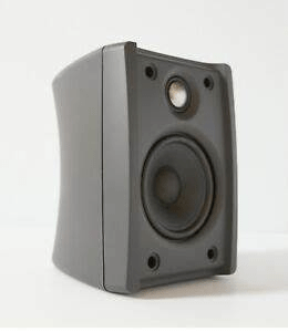

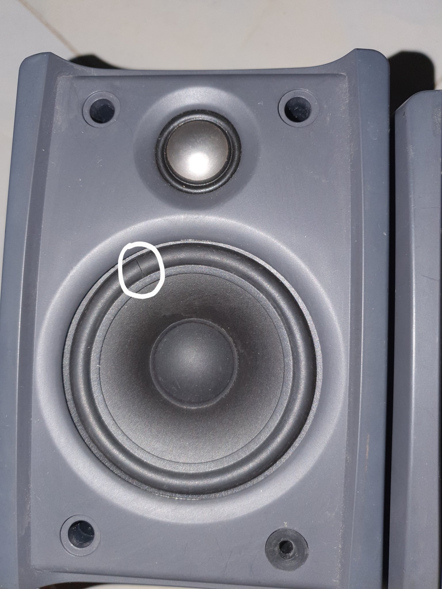

One of the surround speakers has a cut in the outer surround of the mid driver.
Does this image show the S700 surround speaker to which you are referring?
You could let us see a photo showing the extent of the damage to the driver surround.
I would simply seal the cut (front and rear) with this permanently flexible black sealant:
