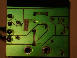

Hi Bob
I tested the components on both cross-overs with multi-meter. Coils and resistors on both the good and the bad cross-overs show same reading, ie 0 ohm (needle of the meter swings all the way to the right). As for the caps, all of them also show similar readings, ranging from 5 to 10 ohm. So, there's no difference in their readings during the tests and thus it seems that the problem doesn't come from them.
I went back to test the continuity of the wires from the cross-over to the drivers. They showed 0 ohm and thus continuity is not broken.
Then I turned to test the wiring from speaker terminals (in this case, the +ve and -ve terminals on the cross-over circuit board, because they have now been separated from the speaker enclosures). First I contacted the +ve pole of the meter with the +ve terminal and tested all wires to the HF and LF drivers with the -ve pole of the meter. Afterwards, I reversed the meter poles and did the same test. During the tests to both the cross-overs, meter showed readings - either full swing to the right or short swing then back down.
However, when these tests were done on the -ve terminal, while the good cross-over showed reading, there's nothing from the bad cross-over. So, is the problem coming from the continuity between the speaker terminals and the cross-over?
In fact, I just discovered that there's a crack across the back of the bad cross-over circuit board. When I connected the multi-meter's poles between this crack and the speaker terminals on the board, reading showed up, ie needle swing all the way to 0 ohm. Is this actually the culprit? If yes, can I repair it by soldering the crack?

Hi Pat,
Yes, this crack you mentioned is exactly the kind of damage that we are looking for here, and I would say that about 99% sure this will solve your problems when it is fixed.
As I have said all along, it is much more likely to be a break in continuity somewhere, as when caps etc. go bad, one usually hears some signal still, albeit at a lower level and possibly distorted etc.
A complete break in any track like this and in this location will prevent the entire signal from passing through to (or from) both drive-units (which accords with your symptoms), and it should be easy to fix. I don't wish to 'teach my grandmother to suck eggs' here, but in case you are not very familiar with such repairs, I hope that the following might be of some help.

Hi Bob
Thanks for the detailed steps for the repair. Before proceeding to do so, I wonder if I can just simply solder a wire between point A and B as shown in the picture (attached herewith) of the cross-over PCB to fix the problem?

Hi Pat,
Now that I have seen what this looks like, yes you certainly could do what you now suggest, and this will probably be much easier for you. Maybe I should have suggested this before as an alternative, but I had no idea of the physical layout or how wide this particular trace is before seeing this pic.
You should use some substantail wire for this, though, and I would suggest ideally something of a similar gauge to your speaker wires, as this looks like it is the negative 'return' from both drivers which has broken. This trace will carry some quite high currents, but any wire of a similar gauge to your usual speaker wires will be OK, as this trace is only effectively an extension of these speaker wires, anyway.
Lastly, that will certainly be the cause of your problems, but I wonder how such a large crack across so much of the PCB can have happened?
Hi Bob
Problem solved by soldered wire between A & B. I'm hearing them for the first time and reasonably good for its size (I got them from ebay and had one dead on arrival, but seller didn't agreed to accept return for refund). I'm still trying to figure out how this crack on the PCB had come about. Anyway, thank you for your advice and guidance throughout the repair. This is my first one and a satisfying one too. Thanks again.
