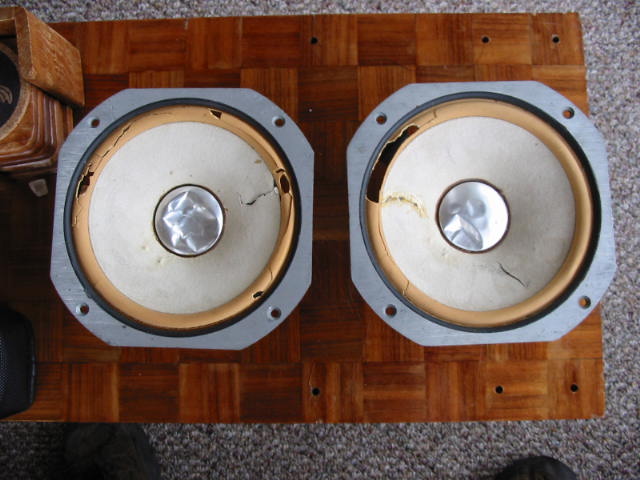

OK !having spent all my money on EV , TAD , Lowthers I've got in my posession a pair of JBL LE8 (old rusty alnico mags) full range drivers with surrounds changed. Frankly, these are the best drivers I ever heard. Tonally, they smoked Enabled lowthers DX4's and nothing (maybe some vintage Tannoys I briefly heard years ago) comes close to my ears. There are two problems with them . Voice coils are partially shorted and both drivers measure 1.3 ,1.5 Ohm DCR . Painted aluminium dust cap was ,is, a little ringy.
Is there anybody who could for resonable (very) amount of money:
take them appart (I probably can do it ) check if the short in VC can be fixed
eventually rewind the VC (maybe even with silver wire ) ,try phase plug instead of alu dust cap (I intend to use a tweeter anyway) measure the speakers ,play with them as long as one pleases and send them back??

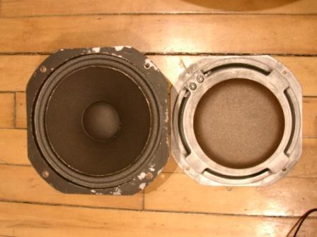

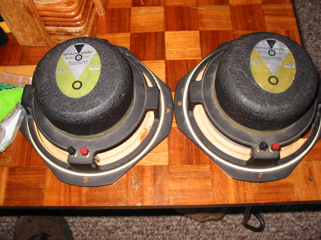

The price to recone made mine expendable. No one wanted to use anything but original parts and that would have cut way too far into the beer fund. I agree they are a great driver but honest to betsy these were going to cost 300USD each cone plus install and shipping. No, I gave them to charity. 😉
The dust caps on mine were attached to the top of the coil so they got that extra bit of extension. Yes they were the LE8T. Thanks for the pic of yours.

OK I thought that you still have them and since the cones are trashed the coils could be reused.I know that original recone kits are $$$ (if you can get them). Well time to prepare acetone and a razor blade 😉

limono said:Well time to prepare acetone and a razor blade 😉
Try a hot air gun and palette knife first. 😉
Hot air gun to loose up suspension ? It's been 20 years since I repaired a speaker and I remember we usually soaked up suspension (upper and lower) with acetone and waited overnight to loose it up . Than mandrel with thin paper around matched to voice coil diameter. Than search for magnet wire...

Thanks for your thoughs. My speakers move freely ,no strange noises, no signs of rubbing , loose coil etc. Just both of them reads LOw DCR ~1,5Ohm instead 5.7 Ohm (or so). Lets try the heat gun. and check it out.
limono said:Hot air gun to loose up suspension ? It's been 20 years since I repaired a speaker and I remember we usually soaked up suspension (upper and lower) with acetone and waited overnight to loose it up .
Acetone is certainly a viable approach to dismantling, however I've noticed it seems to soften the cone material in some speakers. The hot air gun method with a palette knife to scrape at the softening adhesive is one I always try first, just in case, before resorting to solvents. As for your DCR issue, have you tried testing T/S? They may be 4 Ohm V/Cs that just measure low on a DVM.

I thought about it but they are 50W rated speakers (AFAIK) and can't take even 2W .Never saw a dynamic speaker measuring 1.3 DCR. I used hot gun on one of them -works like a charm on a new foam replacement -thanks a bunch for the hint.Accordion lower suspension will have to be soaked up in accetone and left overnight , maybe even more but it started snowing already (can't stand this winter anymore )and I can't move on. Once I'll take cones from the baskets I'll post a picture.
