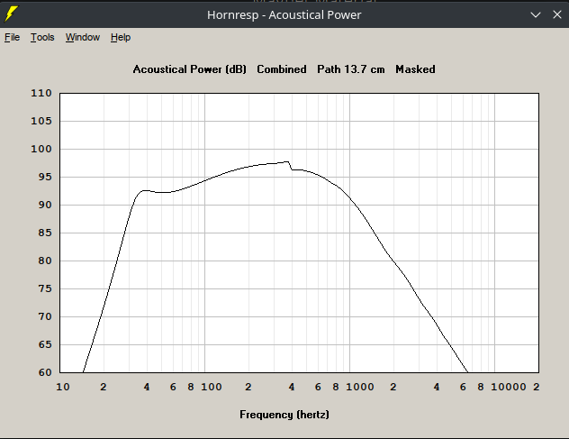

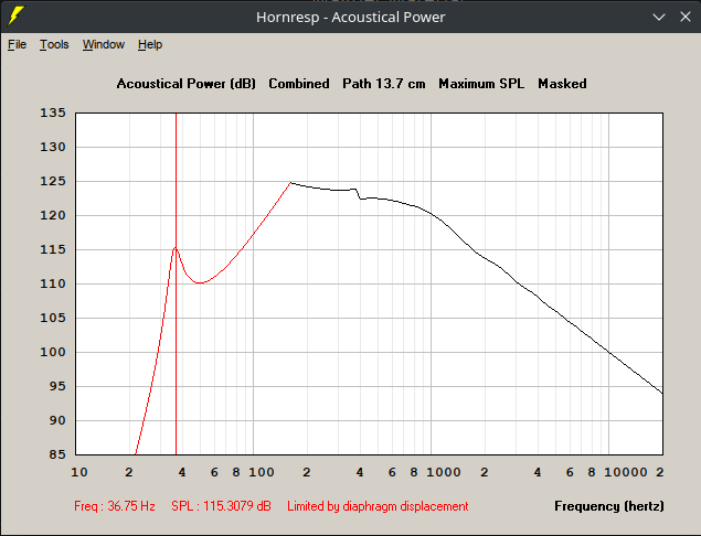

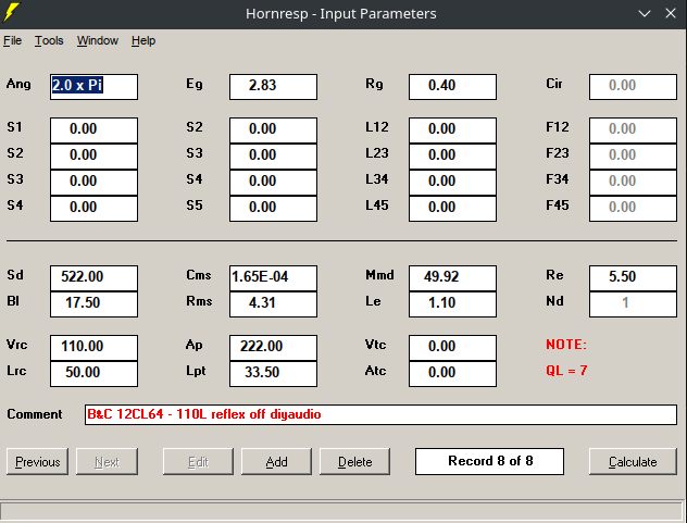

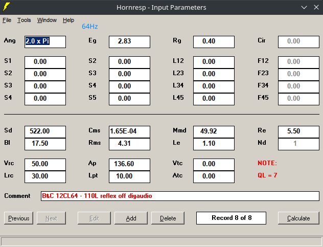

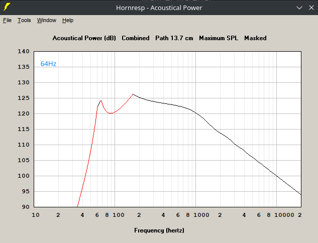

Here are some simulations in Hornresp. Some are meant to show 110L with 35ish Hz tuning. The others are meant to show 50L at 64Hz tuning, for the sake of comparison. Charts with red lines are meant to show maximum power / xmax limited SPL, assuming 500W and 4.5mm xmax. I have no idea whether the input parameters are correct!
