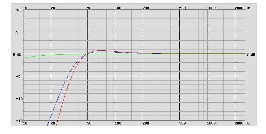

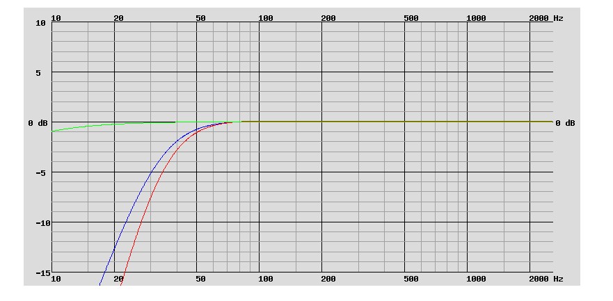

Guijs,
Make sure you have the old spec-ed NHT 1259 and not the new MAD1259, they are different.
Below I show graphs for the equivalent of the NHT 1259, Dayton Audio UM12-22 12" Ultimax (#1) and similar SB Acoustics SB34NRX75-6 (#2) in a 85L/3ft³ sealed enclosure. 😀

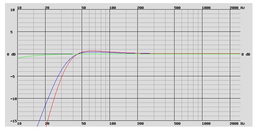

Another alternative/option for a 8 Ohm driver selection it's Dayton Audio RSS315HFA-8 (#3).
Dayton Audio RSS315HFA-8 12" Reference HF Subwoofer 8 Ohm 295-445

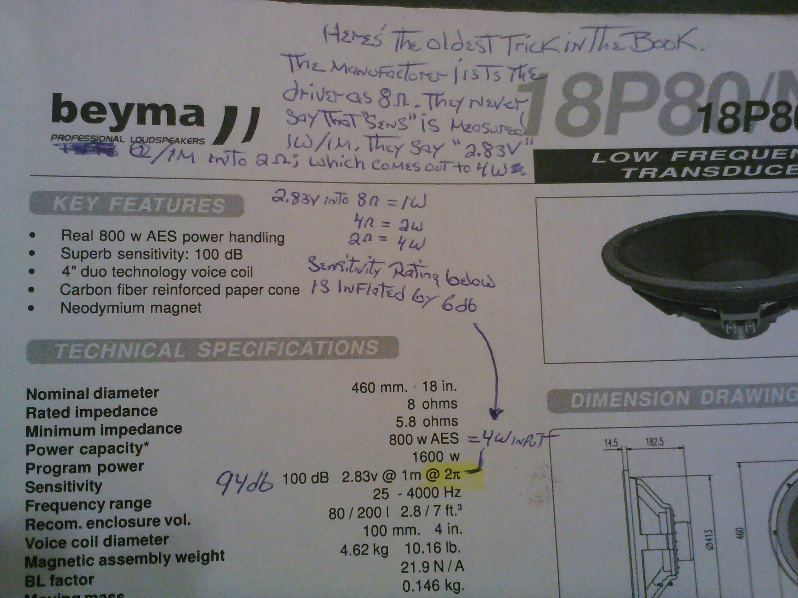

"...BTW the SB Acoustics SPL is 90db..."
Just to compare apples to apples, you see on the SB Acoustics spec sheet, down where it says' "Sensitivity (2.83v/1m) 90db...", gotta watch that stuff. there's a little trick that some manufacturers use to bolster upward a product's weak points. You notice that it says'...1/m, but it "doesn't say", 1w/1m?? That's because they claim to have fed the driver 2.83 volts, but into 6 ohms instead of an 8 ohm load. 2.83 volts into 8 ohms equals one watt. But 2.83 volts into 6 ohms equals 1 and a half watts; who knows, maybe they fed it two watts. that's no accident, a lot companies use this trick and if you're not careful and read exactly what's there, you'll miss it. There's another pro-sound speaker company by the name of "Beyma", who published a doctored-up spec sheet to make a poor sensitivity number look much better by feeding 2.83 volts (which should've been into 8 ohms), into 2 ohms, which comes out to be 4 watts; that's 4 times the input, just to make the sensitivity (SPL) output read 100db; that's 6db higher than it really is. Let me see if I can upload their "faked-up" spec sheet:
rig
Just wanted you guys/girls, to watch for this trick; it's pretty common so keep your eyes open. See the sensivity rating on this sheet. It pretends to be 100db @ 1w, or 2.83V. The trick is, 2.83v is one watt, when fed into a 8 ohm load. But when you feed 2.83 volts into a 2 ohm load, it then becomes "4 watts", which will give you four times the output, or 6db. This becomes very problematic for those who may be comparing to other pro drivers, with intention of buying by the (truck load) skid. Take a look:
18P80Nd - Beyma
The trick is...
rigtec,
THERE'S NO TRICK HERE from what I see with Beyma.
Beyma it's an actual world leader driver producer and one of the best (type here old school) in respect of fairness with drivers quality, measurements/specs and technical support. It's data is supposed to be very accurate until proved the contrary. Beyma Professional Loudspeakers

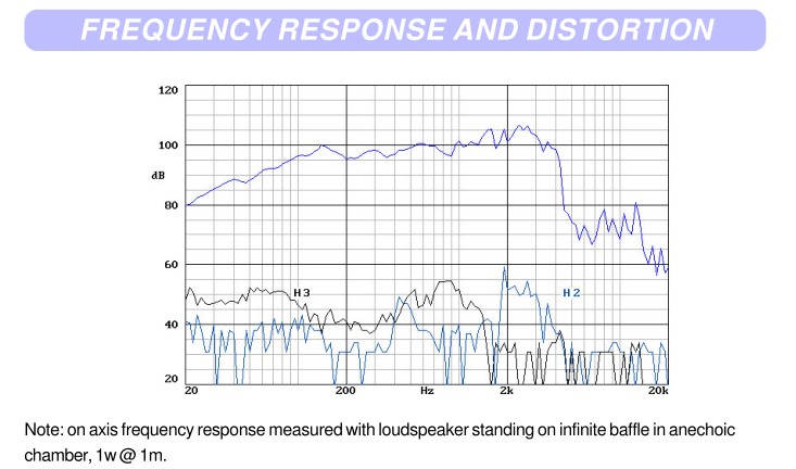

Now to the problematic Beyma 18P80ND you mention (link here):
The 100dB is not the sensitivity in the low frequency extension of the driver but a media of the total output in the frequency graph what can give some misuse because most of the time they are not used in the top part of the specter in the high fidelity loudspeakers, some time it's used in guitar speakers. Some manufacturers knowing this reduce the data to say, a lower frequency before breakup. Each manufacturer have their policies but also have very rigid international ones in the technical domain, agreed to follow.
For this driver and using the formulas for the lower frequencies sensitivity, that are going to be used in a similar situation, I have
In a OB (baffle) SPL
Sensitivity in 2Pi steradian:
99.7 dB/2.83V/m
97.8 dB/W/m
Sensitivity in 4Pi steradian:
95.7 dB/2.83V/m
93.8 dB/W/m
In a speaker (enclosure) SPLb
98.6 dB/2.83V/m
96.7 dB/W/m
94.6 dB/2.83V/m
92.7 dB/W/m
