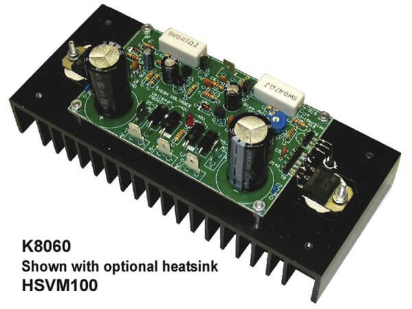

Your 11 dollar IC mono amp board is only rated at 15 W music power into 4 ohms (around 7.5 W continuous or RMS power into 4 ohm).
The amp will likely struggle to push 2 W RMS into your 16 ohm speaker system, even with a suitably beefy power supply.
The most obvious solution to me, as you mentioned, is finding a more appropriate amplifier - one with a high enough RMS power output into 8 ohm that it doesn't run out of steam into 16 ohm.
Something like the following board which is capable of outputting 70 W RMS into 8 ohm:
https://quasarelectronics.co.uk/Item/velleman-k8060-discrete-power-amplifier-200w-kit
Note the requirement for a substantial heatsink and a high power transformer.
P.S. The transistor amplifier above should drive a 16 ohm load without a problem.
That amp would work, but I'd need a chassis to mount it in.

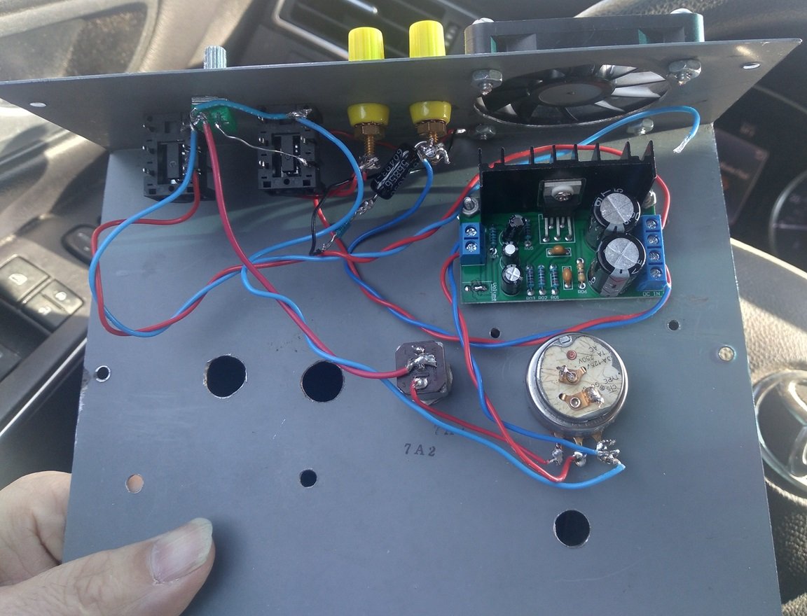

I currently have the 15 watt amp in a small metal case which is where the new amp board may go.

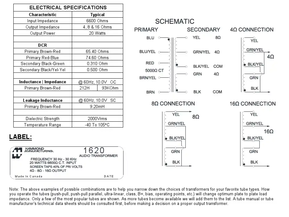

That said I'm kind of wondering if a transformer with a secondary that has an 8 and 16 ohm tap will work feeding the amp to the 8 ohm tap and the speaker to the 16 ohm tap with the common going to the speaker and amp.
Went ahead and ordered the amp off Amazon as if it is not suited for this project or if the transformer works I can always use it for something else.
I do have a Hammond 1620 I could try.
Not sure I understand how the impedance taps work as it doesn't seem right.

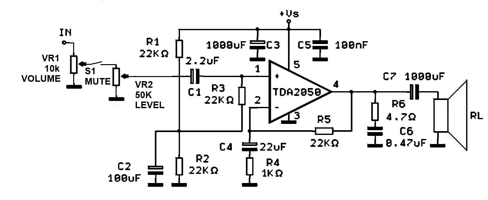

The qkits board is an LM1875 based mono amplifier module.
The Amazon board is a TDA2050 based mono audio amplifier module.
Both could be good for around 10 W RMS into 16 ohm given the use of a power supply with the maximum voltage and current specifications.
P.S. I have to admit to having no practical experience with either of these amp chips.
I did try the transformer and it seems to work ok, however I do not want to tie up a tube output transformer as something that just steps up a speaker level signal.

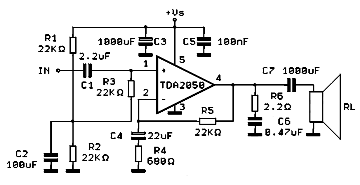

It's likely they used the datasheet single supply example circuit and just added a volume control.
https://www.st.com/resource/en/datasheet/cd00000131.pdf
I have a 0-40V 3A supply at work that I currently use to power the 15 watt amp so I'll use that for this amp.

I do have a 60mm X 10mm fan in the case that pulls air over the heatsink of the current 15 watt amp so I'll leave that in to keep the new amp cool which might negate the need for a better heatsink. Now given I can run the amp on a B+ higher than 16Vdc I'll need to figure the best B+ voltage and increase the series resistor to the fan so that it can run on the higher B+.

The amp boards arrived.
They have a 1000uF 35V cap on the input and also a 1,000uF 35V cap to couple the speaker to the amp.
I still wonder if the Chinese read the datasheet wrong and think the chip can only handle 24Vdc or if the chip is a poorly done clone and is only rated at the lower voltage.
I'll know tomorrow when I apply a higher voltage to the board.

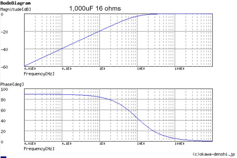

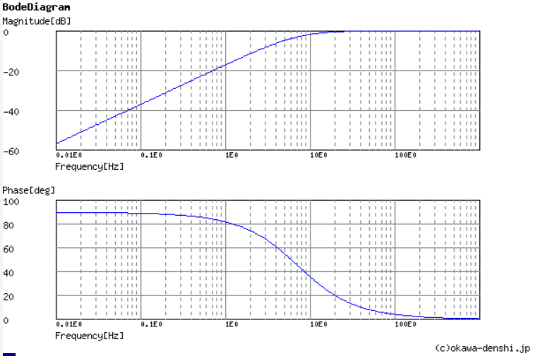

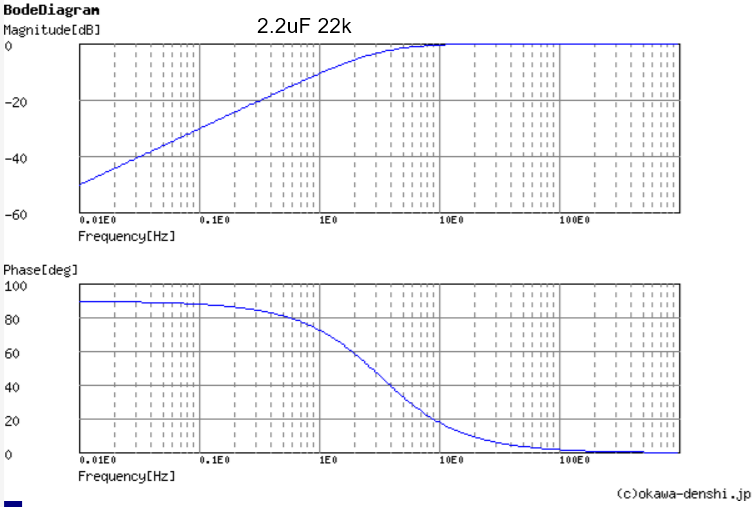

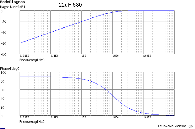

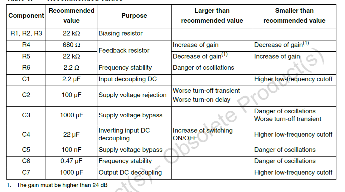

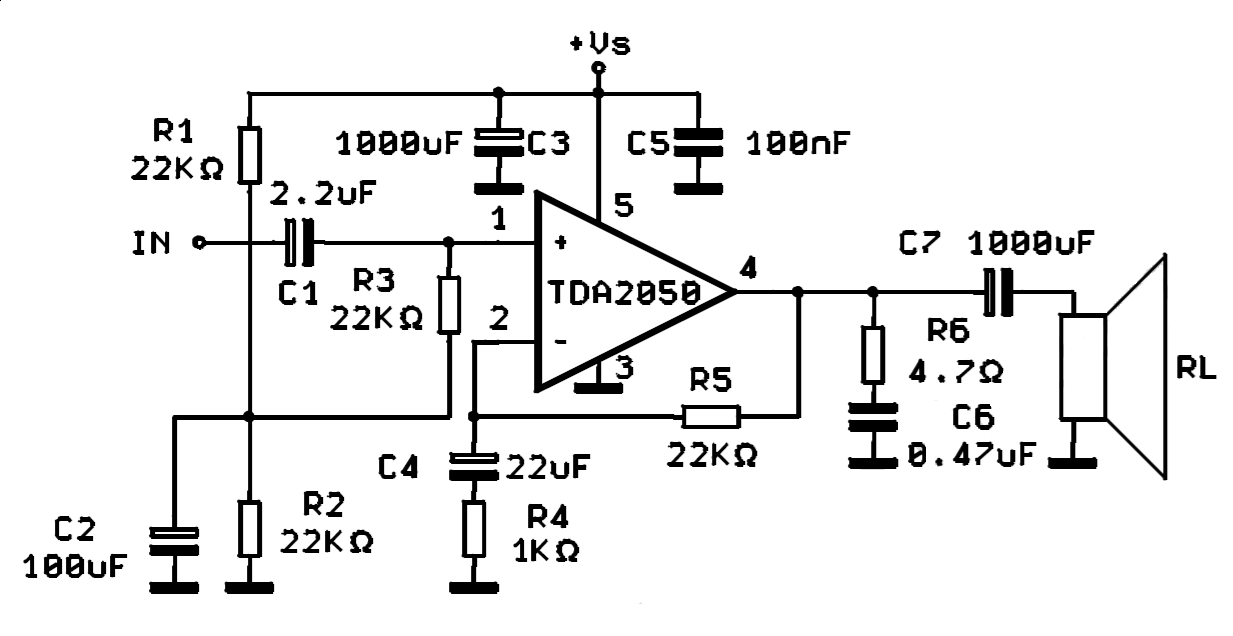

So here's the datasheet version of the amp.
Here's calculations of the capacitors.
C1
C4
C7
Here's the actual circuit. Only two resistors were changed in value. Not sure how that will affect the circuit though.
Here's the calculation of the one cap where the resistor changed value.
The plan is to use the amp as is only removing the volume control and using the volume control already mounted to the box the amp will go in.
The speaker itself I know won't play down to 20Hz.
Now If I wanted to reduce the low frequency phase shift I know that I can for sure up the value of C1 with no real adverse effects. 10uF would get the phase shift near 0 degrees at 20Hz.
Not exactly sure what increase of switching on and off means for C4. I'd need a 220uF cap to get the phase shift near 0 at 20Hz. That one I seriously doubt I would want to increase the value that high.
Now increasing the value of C7 will increase the turn on thump which is neither good for the speaker nor the amplifier chip as that means the charge current for C7 has increased.
I'm also concerned about the value chosen for R6.
I figure they either:
1. Had a bunch of 4.7 ohm resistors and used them and found the amp still stable.
2. Found 4.7 ohms improved the sound.
3. Found that 4.7 ohms worked best with the TDA2050 they made.
Also R4 being a little larger in value increases the gain slightly.
C1
C4
C7
Here's some photos of the amp installed.

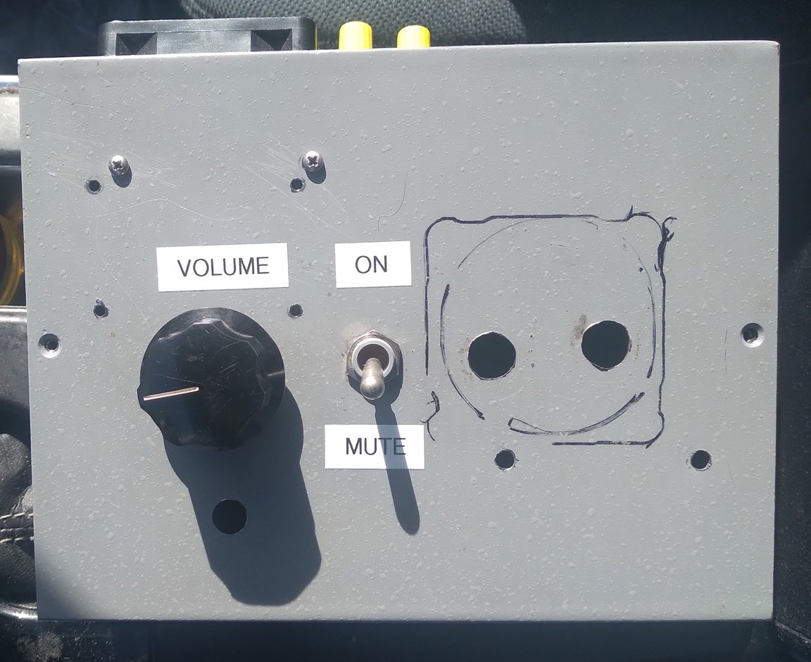

I added the volume control from the amp board to the rear so that the volume control isn't as sensitive. I also have yet to replace the labels.
The schematic changes to this with the addition of the pots.
The amp sounds a little better than the other amp. Seems like the bass is a little better. Running the amp on 24Vdc the amp is more than capable of driving that speaker very loud.
The only thing I might do at some point is replace the cheap Chinese electrolytic caps with some good quality caps.
