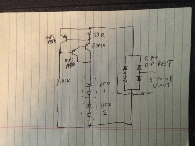

The original design, if you look at the Gerber file, was designed to fit in the same footprint as a standard Tyco 16A relay with exactly the same pin outs. Adding a bridge and then dealing with the dissipation associated with some sort of current source drive on board is no trivial task.One could make the SSR idiot proof by full wave rectifying the input so it sends the current the right way through the photocouplers regardless of how the user connects it. Better than just a reverse protect diode because there would never be an error to correct. Works either way. And one could install a current source in the loop setting the LED current at 20mA, regardless of amp power supply voltage or if an auxiliary supply is there or not. No dropping resistor to calculate. Plug and play.
The DC blocking diode is a 5c solution that solves all the issues you raised.

I think the way we each share our own ideas can sometimes lead to confusion for those reading our circuit descriptions. I understood what you were writing, but I post diagrams now to help onlookers. It helps me, too.Some people want everything done for them…..
I was hoping I wouldnt have to draw it up and take a picture. All my CAD stuff is not on this machine. My idea was to make a universal (or semi universal with board stuffing options) SSR replacement for the big ice cube relays I used to use for speakers protection. In general they ARE large enough to reliably open when a 200-400 WPC amp heads for the 80 volt rail. Used them in the field for decades back in my DJ days (the amps were home made, or at least home modified like adding relays to Phase Linears because eventually one WILL head for the rail). But the supply of cheap ones is dwindling as the surplus houses fold or worse raise prices to the same as Mouser. $2.99 was typical, but now you add a zero. I can buy 8 200V mosfets, two or even four opto drivers and a TVS for that. Then I can add a zero to the amplifer power they can be used with. I’ve got some BIG stuff in development for a bucket list PA rig, so SSRs we’re being designed in.
