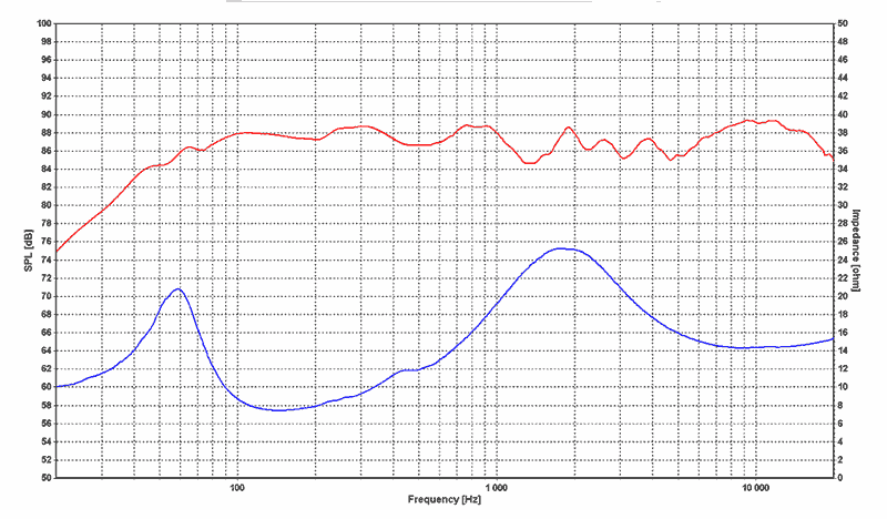

For classic rock and a low watt amp, would the SEAS A26 kit work?
Seas A26 10" 2-way Kit Pair (based on the classic A25)
p.s. Efficiency doesn't look high enough...
Zia,
Many small amplifiers are SE and as such more often than not have a high Rout so one has to worry about the speaker impedance.
I would be very careful trying to use a small SE amp with these speakers due to the artifical upper midrange bloom from the interaction of the amplifier and speaker impedances.
It would be worth trying with a small amp with a low Rout.
The simple design, very simple XO, lead to a box that is quite appealing if somewhat coloured. It is hard for a 10” to go as high as it does.
dave
