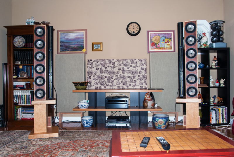

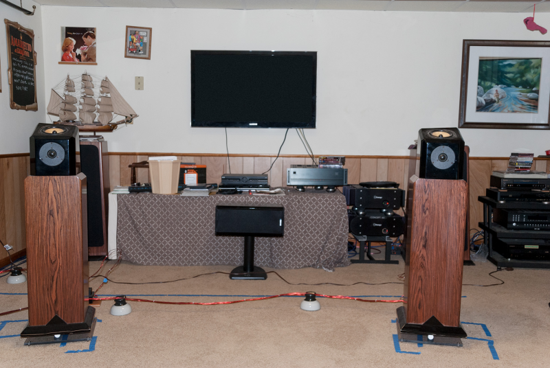

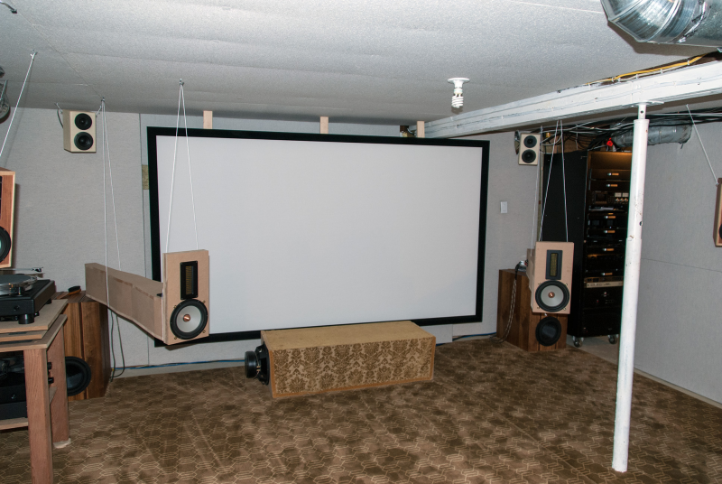

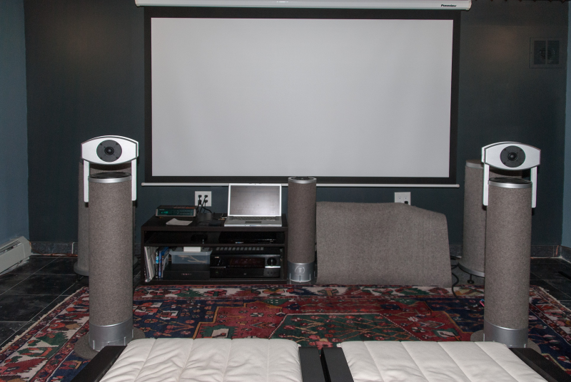

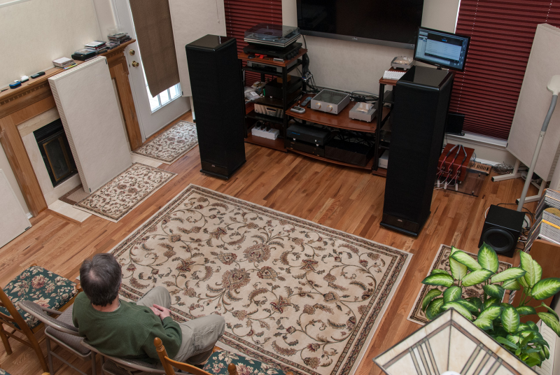

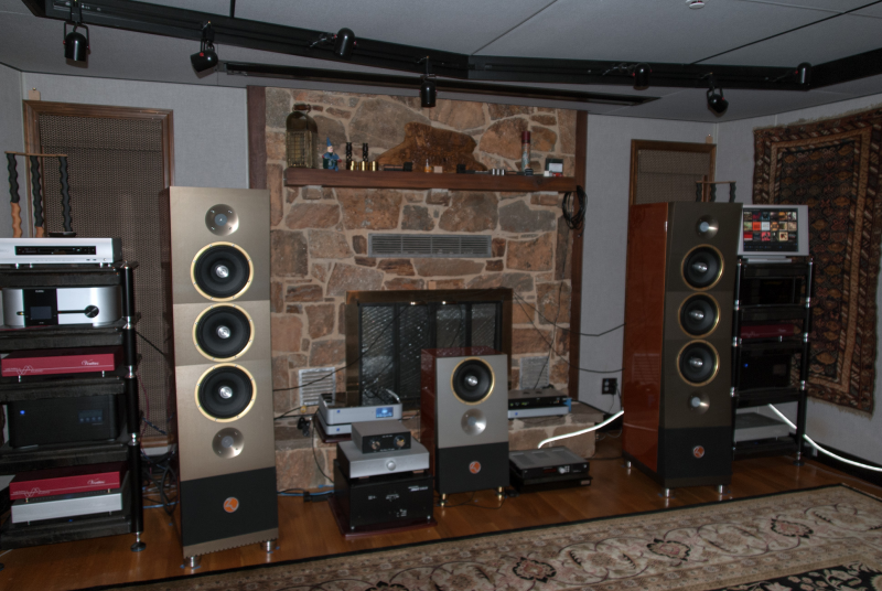

For the best sound stage speakers are always placed at a distance from the walls. And this placement can often be quite critical and may require experimentation to find just the right location. The reason is because of nodes which occur between the speakers and the walls. And they just sound better out there. But in general the placement starts with forming an equilateral triangle with the listing position at the apex. As a thirty year member of a local audio society I have been exposed to a great many systems. Most of them pretty high end. None of them had speakers near a wall. Perhaps a good place to start is with this article. Below are a few pictures from recent society meetings.
