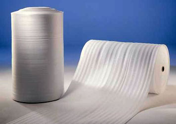

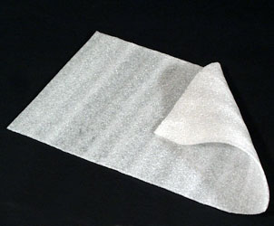

You can use them anywhere you want, you just have to cut them to give them the correct shape, forming a joint to seal and prevent air leaks.
Somewhat thicker is the material used as "under the carpet" but it adapts better to the irregularities of the surface.
