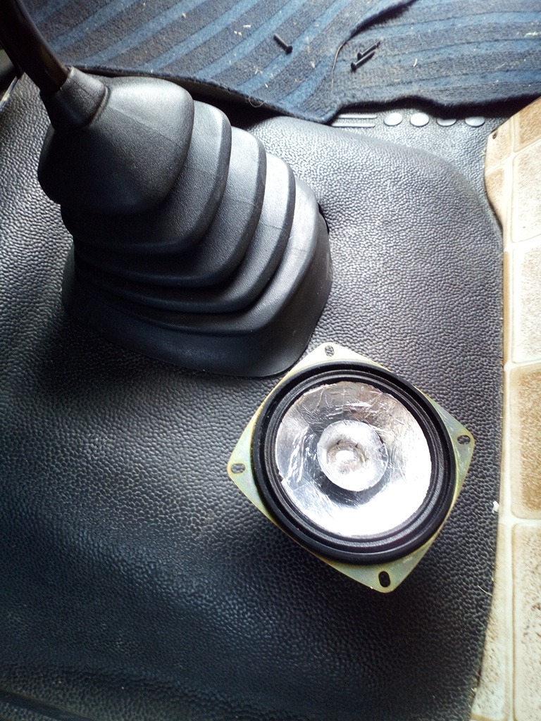

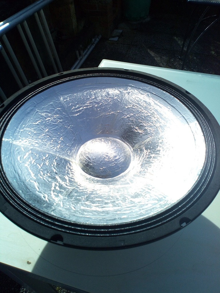

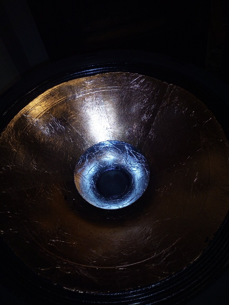

Aluminium foil tweak looks like this for loudspeakers just cut normal aluminium foil for the household into pieces like parts of a cake and glue them with some household glue onto the diaphragm.

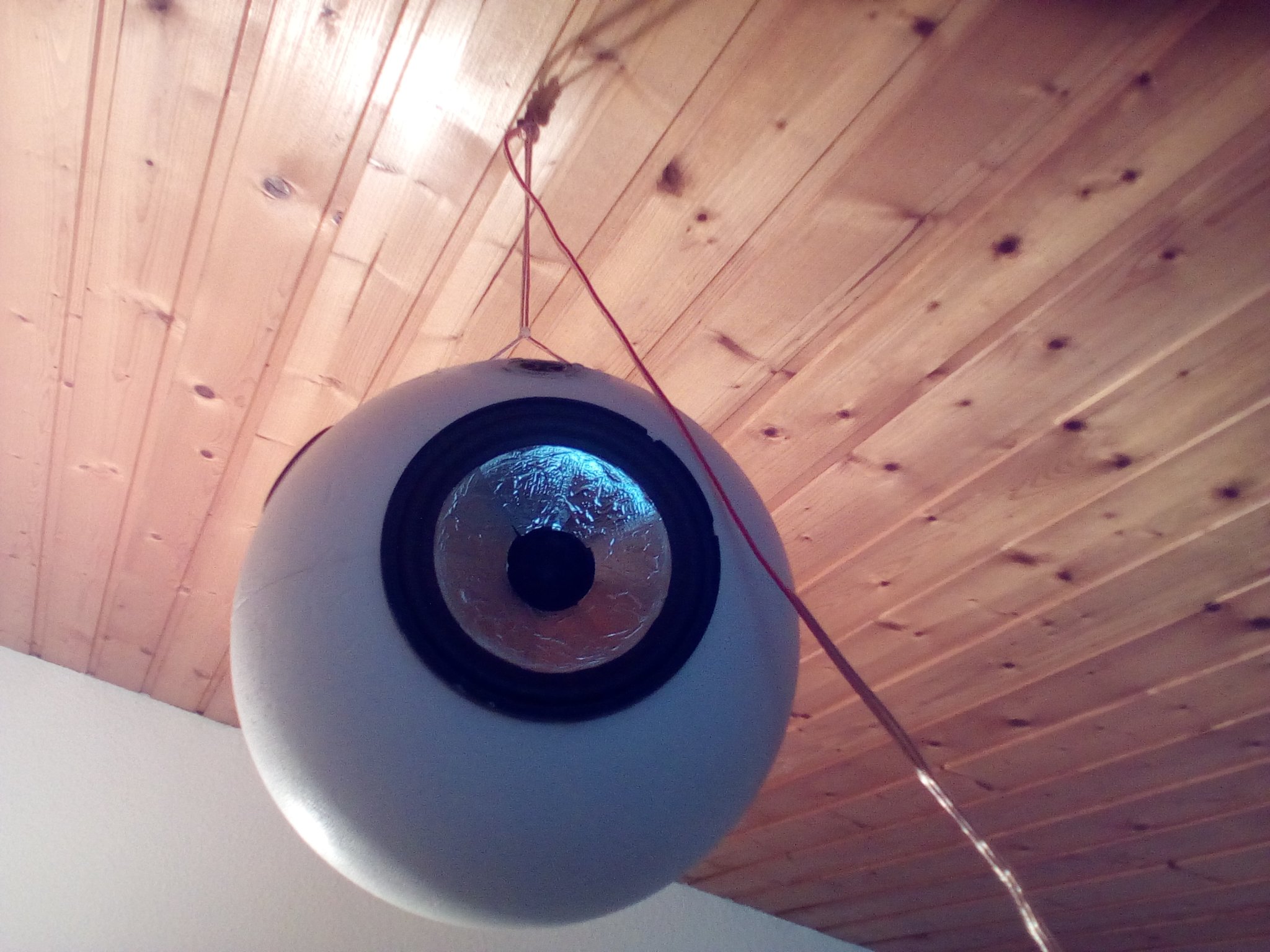

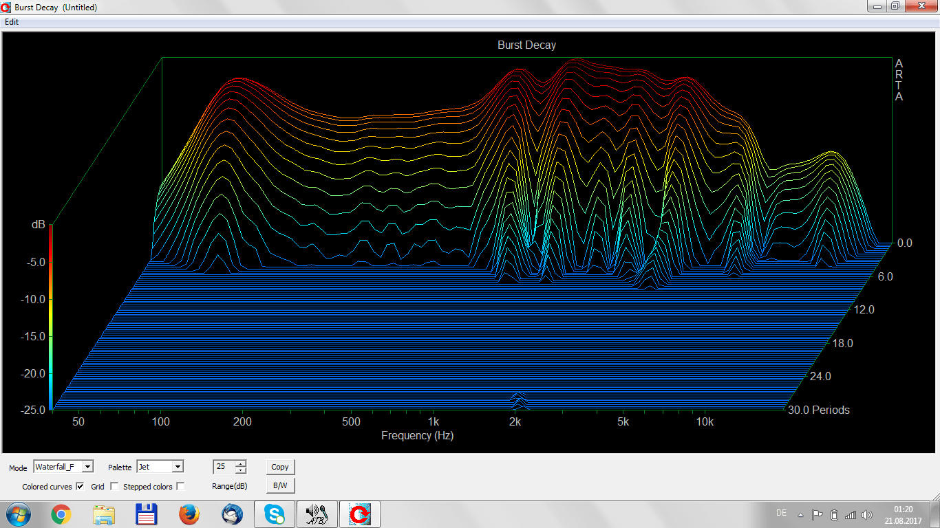

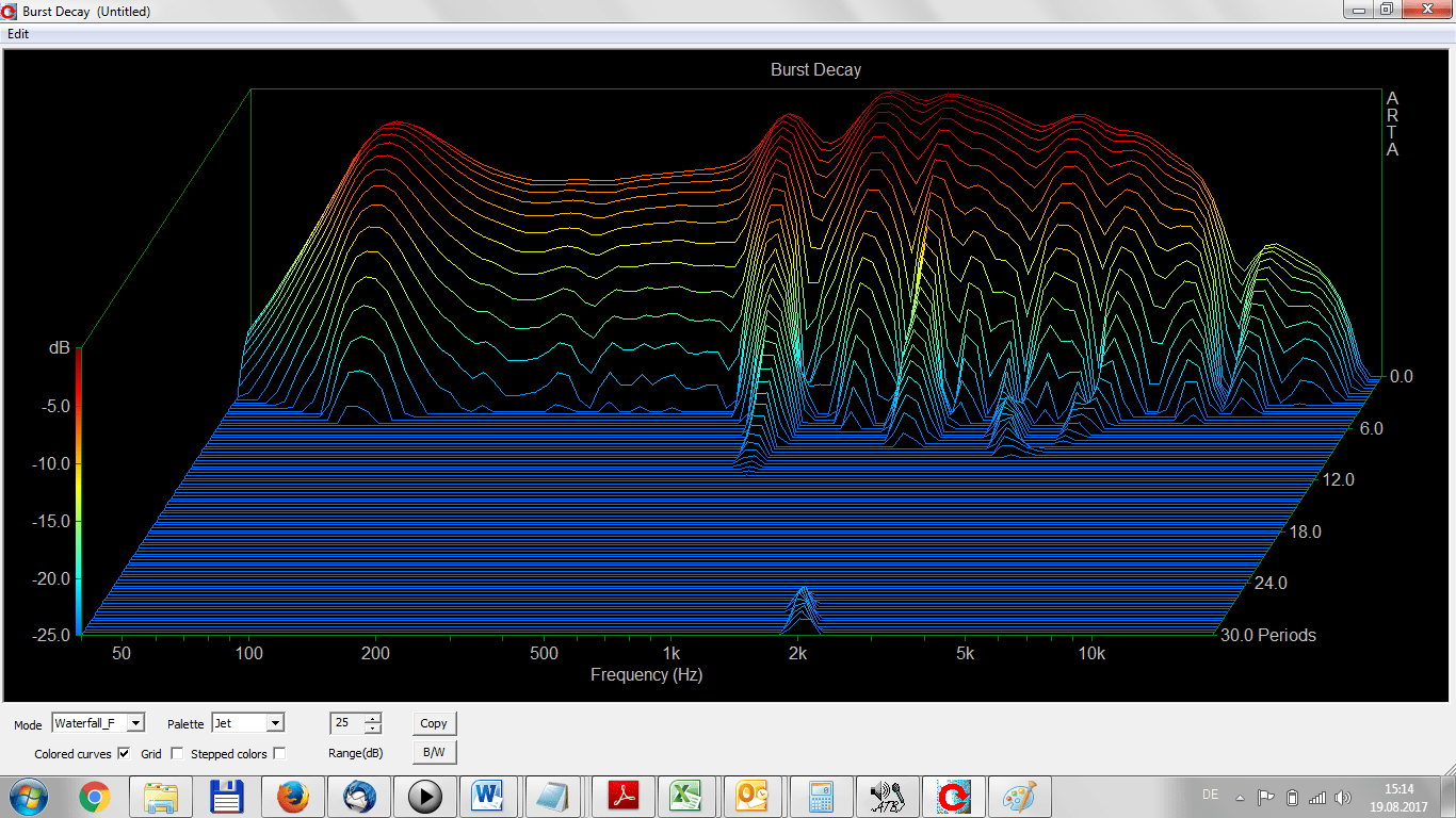

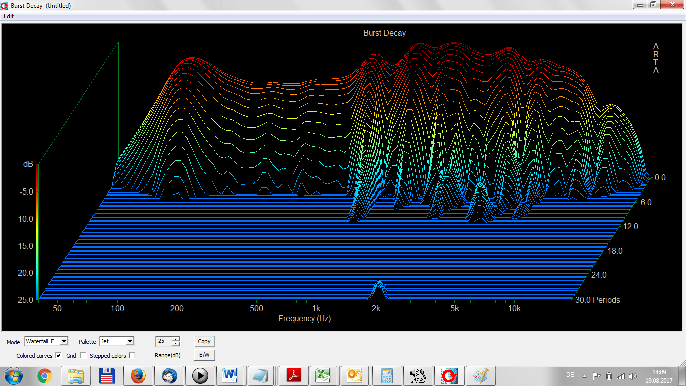

This is a Saba Greencone with aluminium tweak (but very thin foil)
The measurement is immediately after putting the foil onto the driver as I usually do not like to wait to make the measurements.
The frequency response on the upper side of the audio spectrum after some days returns again after the glue has evaporated. It evaporates slowly because the aluminium does not allow for fast evaporation.
One image without aluminium, one image one sided aluminium third image both sides aluminium (sandwich cone)
you usally get a resonance free fullrange loudspeaker or at least minimized resonances but a much stiffer cone which sounds quite high-endish

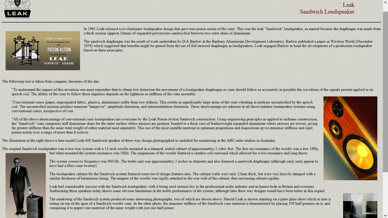

There are a lot of mods for loudspeaker diaphragms.
But really adding stiffness to the cone by putting a metal foil on it has a dominant influence on stability. Much more than any plastics or varnish or hair spray.
Here you can read about hifi history. You should understand that the use of polystyrene brings new resonances to the diaphragm. But covering paper cones with aluminium brings the resonances down. And you can use this tweak without damage to the response and get only the advantages.
Citation: https://44bx.com/leak/sandwich.html
What is a joke is that only for a little bit more money you can get old used Leak Sandwich loudspeakers which are with a little bit care of reexamining the built sound pretty high end - also in todays terms. Maybe only some EQ is necessary to adjust to taste.

Here you see a Sica 12d fullrange driver with copper and aluminium foil. The driver has a faraday ring on the pole piece which makes it sound above average (=less distortion) or use current drive amp to achieve this.
