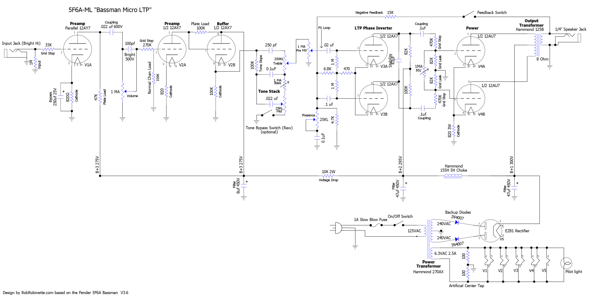

I’m building a proven design micro guitar amplifier using both triodes of a 12BH7 in push-pull for the output. The B+ will be 300V. The Rp of a 12BH7 at 300v is roughly 5.5K. When determining the output transformer primary impedance, the rule of thumb for max power is Rp*2 (single ended) or Rp*4 (push pull). So for a 12BH7 push pull that would be 22k anode-to-anode. However, when I divide the B+ by the half-winding primary impedance (300/11000), I get a 27mA which is beyond the max current for a 12BH7.
Picking a much comfier current, say 15mA, I get the following: 300/.015 = 20k per half winding, or 40k anode-to-anode. I can get this using a 15W 10k::4 output transformer loaded with a 16-ohm JBL D130. The question is is it safe?
So my concern is that a 10k:4 transformer has a voltage ratio on of 2500. So any back EMF from the driver will be stepped up by that ratio and a 16 ohm driver has four times the the back EMF of a 4 ohm driver. My hope is that the 15W rating of a transformer that will be seeing less than half that power might mitigate my concerns about arcing and shorted turns in the primary. Am I wrong?
Perhaps I could use an autoformer + swamping resistor between the secondary and the driver; the autoformer will of course step up the impedance of the driver but the swamping resistor in parallel to the autoformer will be selected to not only make the driver look like a nominal 16 ohm load but will also act as a short for any back EMF.
The other option is to select another off-the-shelf transformer design such as a 10W, 12k:8 and hope that using a 16 ohm driver that presents a 24k ohm load to the 12BH7 is sufficient.

So do you think I am safe using the 4-ohm tap of a 15W transformer with a nominal 16 ohm D130?And to boot, for convenience/tradition we quote plate-to-plate impedance , actual impedance seen by each plate is 1/4 that, go figure.
Consider the 12BH7, Max quiescent ratings:
V plate = 300V
W plate = 3.5 Watts
and max gain with infinite load impedance = u = 16.5
If you operate the 12BH7 at 300V x 0.015A (15mA), the plate is dissipating 4.5W. Ouch!
If this is a push pull amplifier, with 300V B+, and one plate goes to ground (0 Volts), the other plate will go to + 600V (if it has an infinite load impedance).
But that is not likely.
Gain with an infinite impedance load is 16.5, and total peak plate swing = u x bias
The bias to get 300V swing will have to be 300V / 16.5V = 18.2V
With -18.2 volts grid bias, and plate voltage of 300v, you can not get 15mA, Instead you will only get 5mA.

This is a micro guitar amplifier we are considering, how would you advise I change the impedance and/or current draw?
Here is the schematic I am working with:
The fender amplifiers for the build I am attempting switched to a interleaved transformer design for the circuit I am attempting to adapt it to. As such, I am trying to provide this a more robust OPT.
This is what I would like to adapt it to, sans the “normal input”:
Of course the current draw is increased with the extra tubes but the concept remains the same; the output tubes are being replaced by a dual triode 12BH7.

4.5 watts per side is too hot. You need to run the idle current a bit lower. I would aim for 3 watts or less. The typical operation data uses 2.875 watts.If you operate the 12BH7 at 300V x 0.015A (15mA), the plate is dissipating 4.5W. Ouch!
Remember, this is a guitar amp. Somewhere, sometime some dummy like me will plug a pedal board into this thing, set the controls for the heart of the sun and cut loose driving those output well past clipping. I have seen peaks of over 2500 volts in a working guitar amp that ran 6L6GC's on 430 volts of B+ when playing notes that were around the speaker's resonant frequency. The 12BH7A is however rated for such nonsense. There is a peak positive plate voltage spec of 1500 volts to accommodate the retrace pulse seen in TV vertical sweep operation. Build the amp with whatever OPT you like, play with it, then set the idle current for a point that gives you the sound you like and keeps the plate dissipation down under 3 watts per side. Use a ceramic socket to withstand the high plate voltages seen in overdriven use.

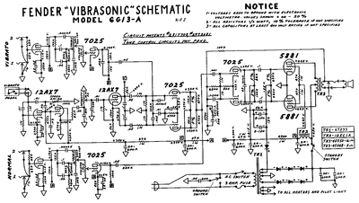

Are you after the Fender Vibrosonic sound also? Then please note the main difference in your schematics: You're driving your tone stack from a low impedance cathode follower, same as Jim Marshall does. Although this also may sound fine (I'm sure it does!), it surely won't sound like the same tone stack driven from a high impedance 12AX7 plate.The fender amplifiers for the build I am attempting

Thanks for looking out.Are you after the Fender Vibrosonic sound also? Then please note the main difference in your schematics: You're driving your tone stack from a low impedance cathode follower, same as Jim Marshall does. Although this also may sound fine (I'm sure it does!), it surely won't sound like the same tone stack driven from a high impedance 12AX7 plate.

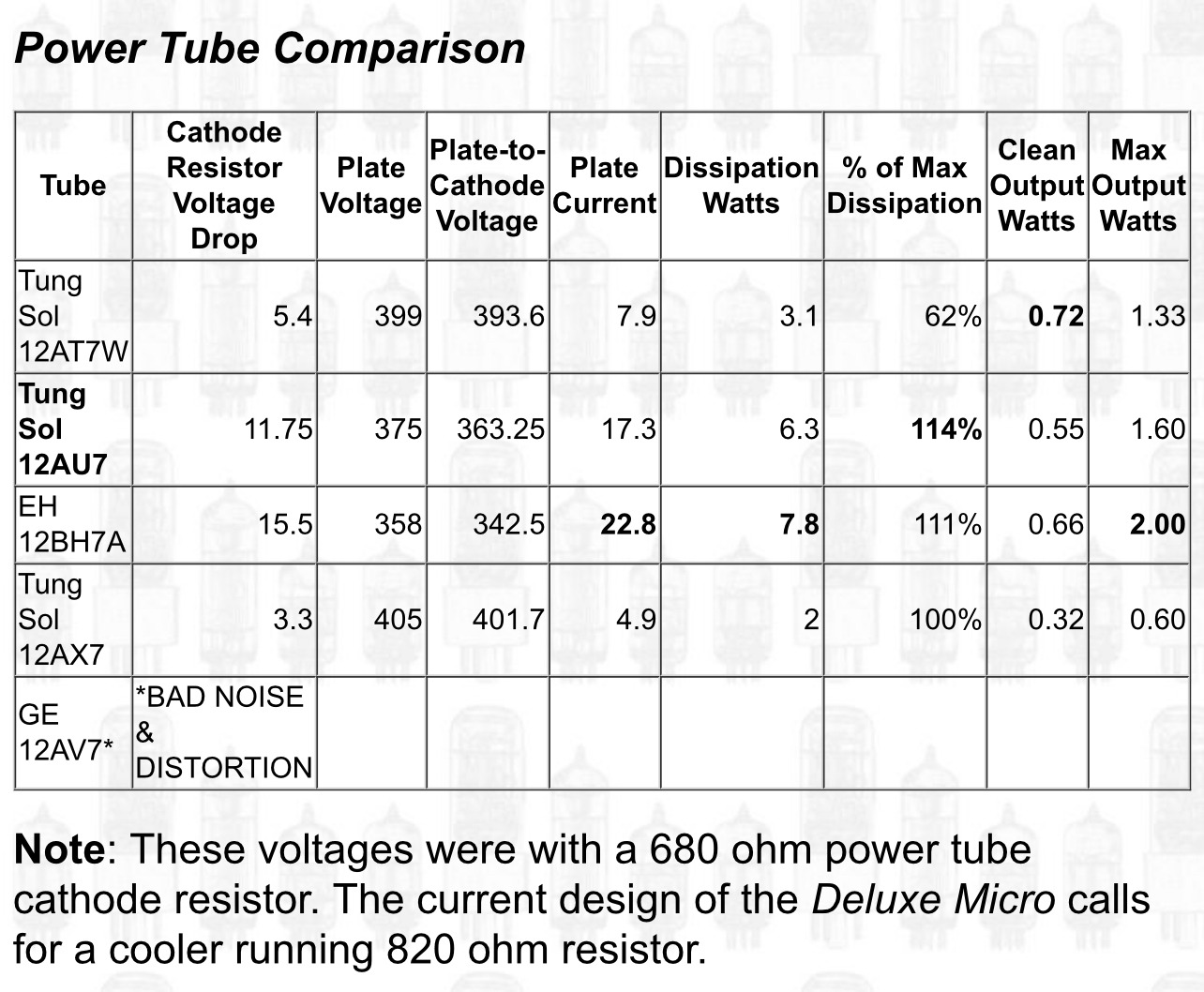

I found this chart regarding various subminiature “power tubes” in the micro guitar amplifier schematic posted above:
Interesting that the dissipation on some of the tubes is higher than is recommended on the datasheets for said tubes. Is this typical for guitar amps?
