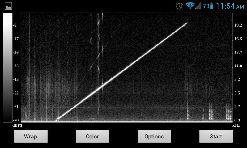

the frequency response of the receiver of cell phones adheres to a prescribed standard envelope and most quality phones stay within the band of 300Hz to 3kHz with several dBs discrepancy!
the speaker measurement would yield most erroneous and tragic results!
A very generalized statement about cell phones. Sure, many phones may have a limited range with the mic, mine handles the full spectrum. Not saying its pro quality, but it gets the job done just fine for me.

What I had in mind was to get a calibratable android app. for my Samsung Exhibit phone, and simply match it to the results of a high end mic and RTA that a rich friend has, while we mic high end speakers with pink noise.
Above about 8kHZ, slight movements of the mic can create big differences in readings, even with the best mics, so I take those readings with a big grain of salt. If you're developing speaker drivers, you need everything to be perfect, but if you're just adjusting levels on an active crossover, or looking for typical room effects (which are usually the worse in the lower midrange/upper bass), then it should still be useful enough.
